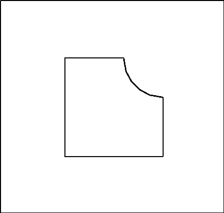

Calculate the temperature distribution in a two-dimensional domain.
Figure 3.1: Two-dimensional heat problem

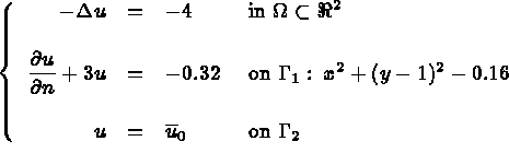

Find u(x) which satisfies:
where
This problem allows one exact solution:

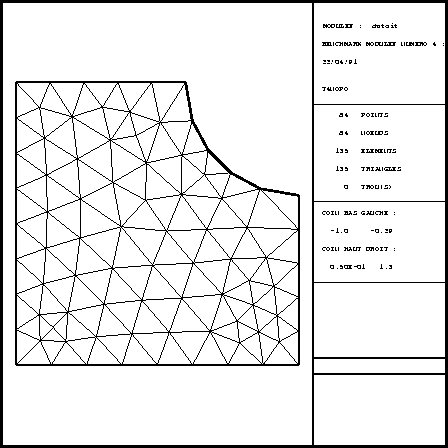

The type of finite element utilized in order to solve this problem: TRIA 2P3D (straight P3 Hermitian triangle)
Figure 3.2: Suggested mesh ( TRNOXX)
Step 1: Mesh
| Execute program: | D4NOXX | |
| Modules used: | APNOPO | ... 2D mesh generator [MODULEF User Guide - 3] |
| TRIHER | ... construction of mesh using Voronoi's polyhedra theory | |
| REGMA2 | ... regularization of mesh | |
| GIBBS | ... renumbering | |
| Libraries: | NOP2, NOPO, UTSD , UTII | |
| Input data file: | D4NOPO.D | |
| Output data structure: | T4NOPO | |

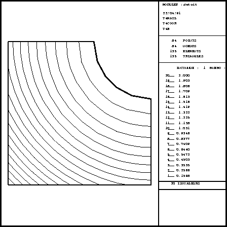

The complete output of the D.S. B, containing the temperature and the temperature derivative in x and y at each node in the mesh, is found in the file S4B.D in library TESD.
The remainder of this section contains a partial or total printout of the various output D.S. of the different programs. These data structures can be viewed by calling preprocessor IMAGXX and specifying the names of the files containing the desired data structures.

A plot of the isotherms is generated by the preprocessor TRMCXX as follows:
| Call preprocessor: | TRMCXX |
| Specify input data structures: | T4MAIL |
| T4COOR | |
| T4B |
Figure 3.3: Isotherms ( TRMCXX)
