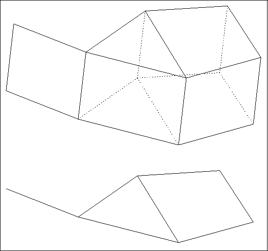

This method enables us to construct a mesh of all domains with a cylindrical topology from a 2D reference mesh by stacking layers of 3D elements. The nature of the 3D elements is deduced from that of the 2D elements of the reference mesh.
In fact, all domains which are possible to define in this fashion are said to be topologically cylindrical.
The data corresponding to this mesh generator is therefore the 2D mesh of a reference section and the definition of the sections along the generating axis.
Figure 3.8:  Correspondence 2D - 3D
This method is known as the translation-stacking method or extrusion method.
Segments in the space are associated to the points of a 2D mesh, quadrangular layers in the space are associated to the segments in the 2D mesh, pentahedra are associated to the triangles, and hexahedra are associated to the quadrilaterals. The connectivity is deduced from that of the two-dimensional basis mesh and from the section index.
In order to be able to treat domains containing the axis of the associated cylinder, it is necessary to consider the cases of possible degeneracy (see example), such as a quadrilateral giving rise to the creation of pentahedra and not hexahedra.
