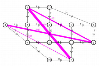

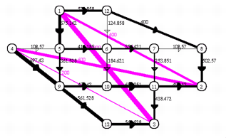

Nguyen Dupuis Net
$net={\rm TrafficExample}('Nguyeen\;Dupuis')$
Figure 4: Non-assigned and Assigned Nguyen-Dupuis Net
\includegraphics[width=70mm]{nguyen} \includegraphics[width=70mm]{nguyenassig}
GP LPF data Demands
$\begin{array}{\vert c\vert c\vert c\vert}
\hline
nn & ln & dn\\ \hline
13 & 19 & 4\\ \hline
\end{array}$ $\begin{array}{\vert ccl\vert} \hline
t0 & \in & [3\;14],\\ \hline
ca & \in & [2.5e-3,\;1.25e-2], \\ \hline
ma & = & 0,\\ \hline
ba & = & 1. \\ \hline
\end{array}$ $\begin{array}{\vert l\vert cccc\vert}
\hline
dt & 1 & 1 & 4 & 4\\ \hline
dh & 2 & 3 & 2 & 3\\ \hline
dv & 400 & 800 & 600 & 200\\ \hline
\end{array}$
Link performance function: \(c=t0+ ca F.\)
This example can be found in: Nguyen S., Dupuis C., An efficient method for computing traffic equilibria in networks with asymmetric transportation costs, Transportation Science, 18, (1984), pp. 185-202.
