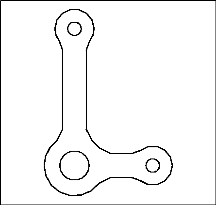

Calculate the displacements and the distribution of stresses for the lever, shown below in figure 2.8, submitted to a point force.
Constraints:
, of radius
have zero displacement in y.
, of radius
have zero radial displacement.
| | if | | ||
| if | | |||
| where | are the coordinates at point |

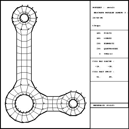

The type of finite element utilized: QUAD 2Q1D
We consider a unit system where the physical values are defined by:
| l | = | 12.0 | ||||
| = | 10.0 | | = | 3.5 | |
| = | 15.5 | | = | 7.5 | |
| = | 7.5 | | = | 3.5 | |
| = | 40.0 | | = | 70.0 | |
| and, | Young's Modulus | E | = | |
| Poisson's coefficient | | = | 0.3 | |
| Point force | P | = | 100.0 |
Step 1: Mesh
| Call preprocessor: | APNOXX | |
| Modules used: | APNOPO | ... 2D mesh generator [MODULEF User Guide - 3] |
| QUACOO | ... mesh utilizing quadrangles | |
| RECOLC | ... 'glue together' meshes | |
| Libraries: | CONV, NOPO, NOP2, UTII, UTSD | |
| Specify input data file: | D2NOPO.D | |
| Output data structure: | T2NOPO | |

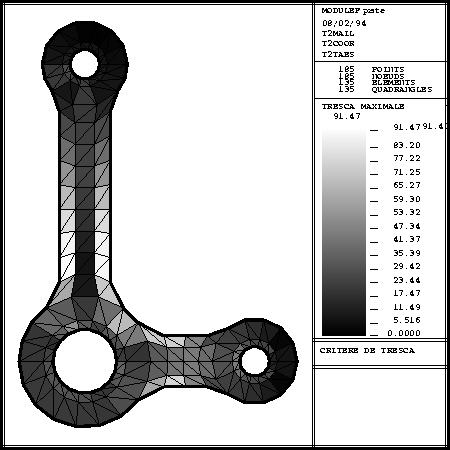

Step 7: Calculation of stresses [90]
| Call preprocessor: | STREXX |
| Specify input data file: | none |
| Output data structures: | T2TAES |
An example of responses to the questions of program STREXX can be found in file TEST.HELP in library TESD.

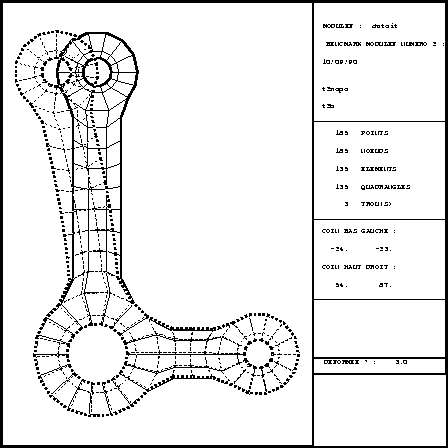

The output of the D.S. B, containing the value of the displacement at each node in the mesh, is found in the file S2B.D in library TESD. The output of the D.S. TAE, created by STREXX, containing the stress values, is found in file S2TAES.D in library TESD.
The remainder of this section contains a partial or total printout of the output D.S. created in each step. These data structures can be viewed by calling preprocessor IMAGXX and specifying the names of the files containing the desired data structures.

A plot of the deformation is generated by the preprocessor TRNOXX as follows:
| Call preprocessor: | TRNOXX |
| Specify input data structures: | T12NOPO |
| T2B |
Figure 2.10: The deformation ( TRNOXX)
A plot of the stresses is generated by the preprocessor TRSTXX
[4]
[MODULEF User Guide - 6] as follows:
| Call preprocessor: | TRSTXX |
| Specify input data structures: | T2MAIL |
| T2COOR | |
| T2TAES |
Figure 2.11: The stresses according to Tresca's criterion ( TRSTXX)
