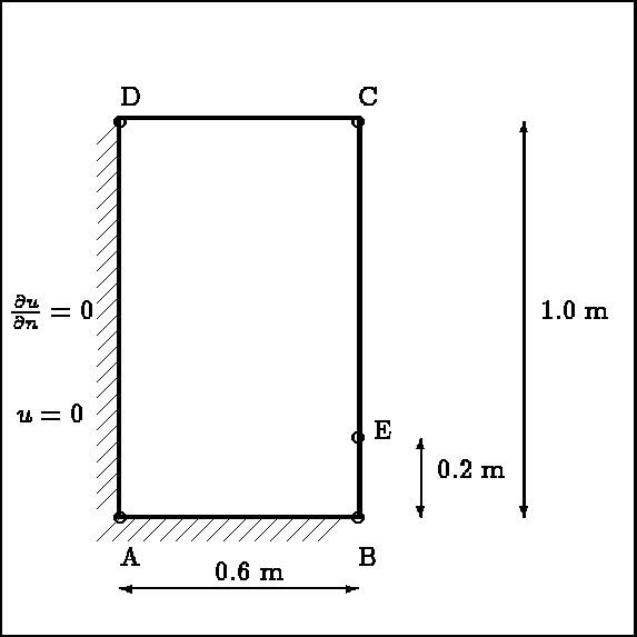

Consider the thermal problem described below:
Figure 2.5: Two-dimensional thermal test with heat transfer
The internal heat production is zero.

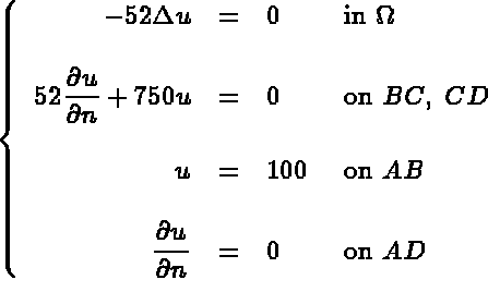

| Boundary conditions: | |
| on boundary AB | T = 100°C . |
| on boundary DA | Zero flux. |
| on boundaries BC, CD | Heat transfer. |
| Surrounding temperature 0°C | |
Material properties:
Isotropic material with thermal conductivity:
The type of finite element utilized in order to solve this problem: TRIA 2P2D.
Result: The known temperature at point E, or at vertex 23 with the coordinates (0.6 , 0.2) is:

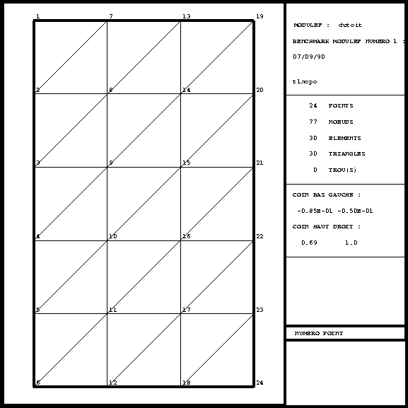

Step 1: Mesh
| Call preprocessor: | APNOXX | |
| Libraries used: | CONV, NOP2, NOPO, UTII, UTSD | |
| Modules used: | APNOPO | ... 2D mesh generator [MODULEF User Guide - 3] |
| QUACOO | ... generation of quadrangles | |
| MODNOP | ... refinement transformation | |
| ADPNOP | ... addition of nodes | |
| GIBBS | ... renumbering | |
| Specify input data file: | D1NOPO.D | |
| Output data structure: | T1NOPO | |

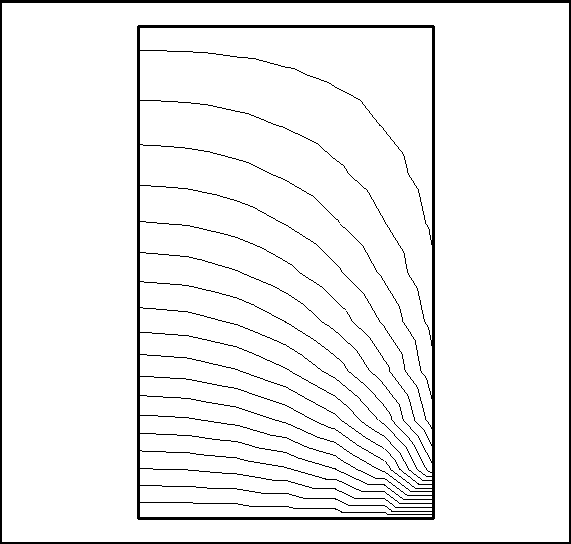

The complete output of the D.S. B, containing the value the temperature at different nodes in the mesh, is found in S1B.D in library TESD.
The temperature calculated at point E (node 70) equals:
The relative error is given by:

PRINT OUT OF D.S. NOPO OF LEVEL 5
TITLE : BENCHMARK MODULEF NUMBER 1 :THERMAL PROBLEM
DATE AND USER'S NAME : 16/11/90 dutoit
DATA STRUCTURE TYPE : NOPO
LEVEL AND STATE NUMBER : 3 0
NUMBER OF ASSOCIATED TABLES : 0
TABLE N O P 2
CHARACTERISTICS OF THE MESH :
SPACE DIMENSION (NDIM ) : 2
MAXIMUM NUMBER OF REFERENCES (NDSR ) : 3
MAXIMUM NUMBER OF SUB-DOMAINS (NDSD ) : 1
NODES AND POINTS DO NOT COINCIDE (NCOPNP) : 0
NUMBER OF ELEMENTS (NE ) : 30
NUMBER OF TRIANGLES (NTRI ) : 30
NUMBER OF BOUNDARY ELEMENTS (NEF ) : 24
NUMBER OF NODES (NOE ) : 77
NUMBER OF NODES BY SEGMENT (NO EXTREMITIES) : 1
NUMBER OF POINTS (NP ) : 24
TYPE OF COORDINATE VALUES (NTYCOO) : REEL1MOT
MAX DIFFERENCE +1 BETWEEN 2 NODES OF AN ELEMENT : 17
NUMBER OF COARSE ELEMENTS (NBEGM ) : 0
NUMBER OF WORDS FOR TABLE NOP5 (LNOP5 ) : 558
REFERENCE AXIS X,Y,Z (NTACOO) : 1
TABLE N O P 4
COORDINATES OF POINTS
| POINT | X | Y | | POINT | X | Y |
| 1 | 0.000000 | 1.00000 | | 2 | 0.000000 | 0.800000 |
| 3 | 0.000000 | 0.600000 | | 4 | 0.000000 | 0.400000 |
| 5 | 0.000000 | 0.200000 | | 6 | 0.000000 | 0.000000 |
| 7 | 0.200000 | 1.00000 | | 8 | 0.200000 | 0.800000 |
| 9 | 0.200000 | 0.600000 | | 10 | 0.200000 | 0.400000 |
| 11 | 0.200000 | 0.200000 | | 12 | 0.200000 | 0.000000 |
| 13 | 0.400000 | 1.00000 | | 14 | 0.400000 | 0.800000 |
| 15 | 0.400000 | 0.600000 | | 16 | 0.400000 | 0.400000 |
| 17 | 0.400000 | 0.200000 | | 18 | 0.400000 | 0.000000 |
| 19 | 0.600000 | 1.00000 | | 20 | 0.600000 | 0.800000 |
| 21 | 0.600000 | 0.600000 | | 22 | 0.600000 | 0.400000 |
| 23 | 0.600000 | 0.200000 | | 24 | 0.600000 | 0.000000 |
TABLE N O P 5
DESCRIPTION OF ELEMENTS
| ELEMENT : 1 | TRIANGLE | S-D : 1 | NUMBER OF STORED WORDS : 7
NUMBER OF NODES : 6 : 1 5 6 2 4 3
NUMBER OF POINTS : 3 : 1 2 7
EDGE REFERENCE : 3 0 2
VERTEX REFERENCE : 2 3 2
| ELEMENT : 2 | TRIANGLE | S-D : 1 | NUMBER OF STORED WORDS : 4
NUMBER OF NODES : 6 : 6 5 11 4 7 8
NUMBER OF POINTS : 3 : 7 2 8
VERTEX REFERENCE : 2 3 0
| ELEMENT : 3 | TRIANGLE | S-D : 1 | NUMBER OF STORED WORDS : 7
NUMBER OF NODES : 6 : 5 13 11 9 12 7
NUMBER OF POINTS : 3 : 2 3 8
EDGE REFERENCE : 3 0 0
VERTEX REFERENCE : 3 3 0

A plot of the isotherms is generated by the preprocessor TRMCXX as follows:
| Call preprocessor: | TRMCXX |
| Specify input data structures: | T1MAIL |
| T1COOR | |
| T1B |
Figure 2.7: Isotherms ( TRMCXX)
