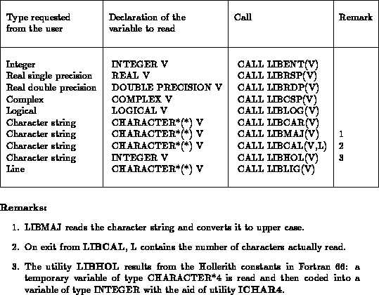

A program can read a scalar, an array, or initiate a command.
There are several utilities at the programmer's disposal, depending on the type of input data. These utilities are described in figure 1.1.
Figure 1.1: The free format utilities
For example, the instruction:
CALL LIBENT(N)
reads the integer, N, in free format.
In order to read an array, it suffices to perform a loop. An array of 10 reals is read in the example below:
REAL T(10)...
DO 100 I = 1, 10
CALL LIBRSP(T(I))
100 CONTINUE
