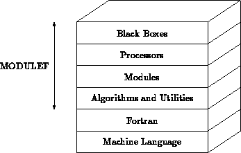

The MODULEF software package consists of a set successive layers (figure 1.1). In the same manner in which Fortran is a higher level language than machine language, MODULEF consists of four layers which are situated on top of that of Fortran (also illustrated in [MODULEF User Guide - 1], section 2.2). The layers situated at the highest levels are the easiest to employ, however, for certain problems it is necessary to return to the layers at the lower level.
Figure 1.1: Utilization levels
In this manner, the user can place him/herself in any of the following situations, listed in the order of increasing difficulty (from highest to lowest levels):
These four situations are described below.
