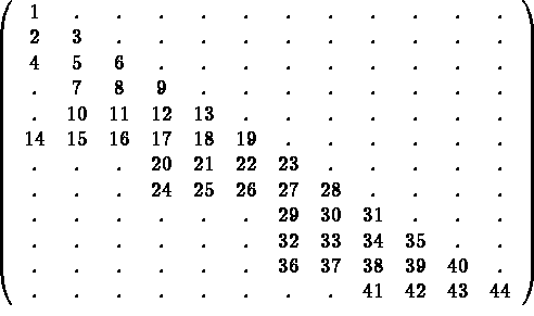

Consider the following 2 matrix examples:
Consider the 12-th order matrix given below (the values correspond to the the rows in the storage and not to the matrix coefficients) constituting 3 pages:
Array MUA5, of length MUA4(13), is subdivided into 3 pages, line 1 to 5, 6 to 10 and 11 to 12. Each page contains a maximum of 22 words. Thus, we have:

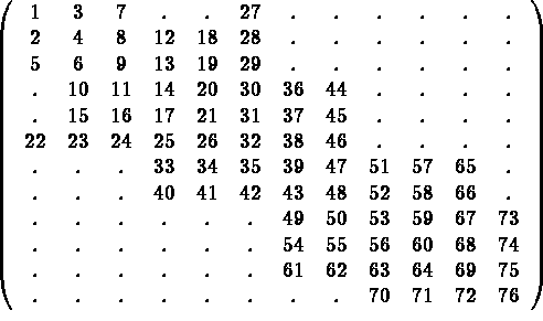

Here, each page contains a maximum of 32 words. Thus, we have:
