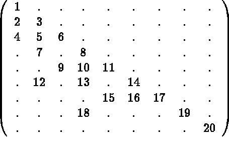

Consider the 9-th order matrix shown below (the values indicated correspond to the rows of the matrix storage and not matrix coefficients):
Thus, we have:

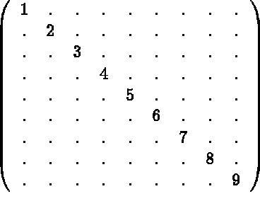

Consider the following 9-th order matrix (the values indicated correspond to the rows of the matrix storage and not to the matrix coefficients):
Thus, we have:

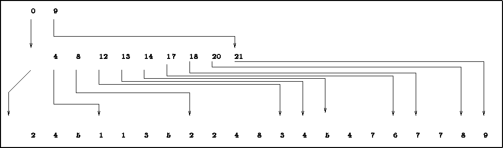

The correspondence between arrays AMA3, AMA4 and AMA5, therefore the position of the matrix coefficients in array AMA6, is illustrated in figure 1.1.
Figure 1.1: Correspondence for example 2

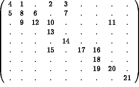

Thus, we have:

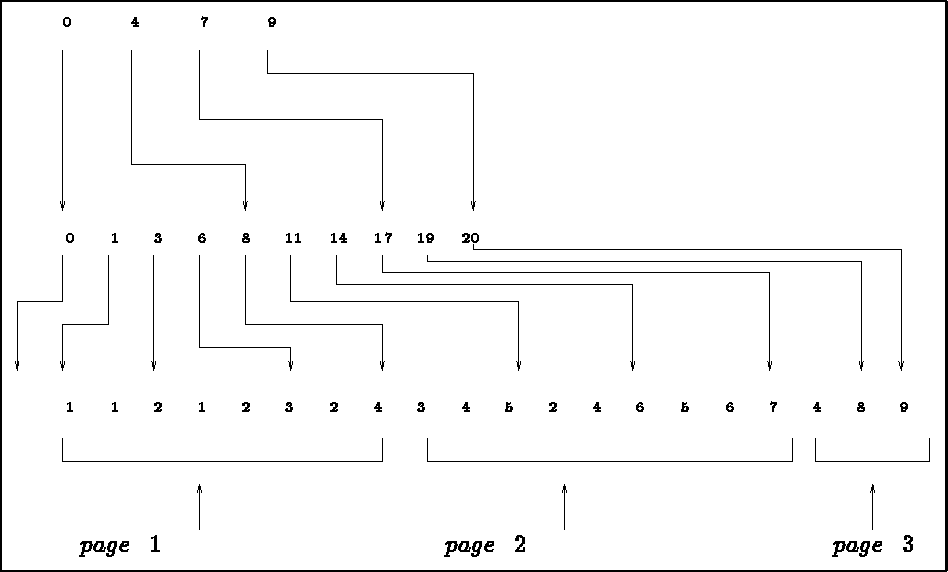

The correspondence between arrays AMA3, AMA4 and AMA5, therefore the position of the matrix coefficients in array AMA6, is illustrated in figure 1.2.
Figure 1.2: Correspondence for example 3

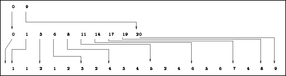

The correspondence between arrays AMA3, AMA4 and AMA5, therefore the positions of the matrix coefficients in array AMA6, is illustrated in figure 1.3.
Figure 1.3: Correspondence for example 4
