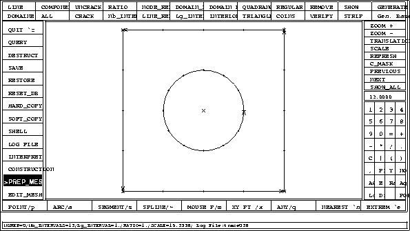

4= on the keyboard
12= on the keyboard
Figure 1.34: Discretization of the lines of the square domain with a hole
The file square_with_hole.emc2_bd :
'-- TYPE N BD(1) BD(2) BD(3) BD(4) BD(5) NBNODE RATIO NUREFG NUREFD NUREF1G NUREF1D NUREF2G NUREF2D FIS' 'DROITE' 1 -1.000000 0.0000000 1.000000 0.0000000 0.0000000 0.0000000 0 0.0000000 0 0 0 0 0 0 F 'DROITE' 2 -1.000000 1.000000 0.0000000 0.0000000 0.0000000 0.0000000 0 0.0000000 0 0 0 0 0 0 F 'POINT' 3 0.0000000 0.0000000 0.0000000 0.0000000 0.0000000 0.0000000 0 1.000000 0 0 0 0 0 0 F 'POINT' 4 0.0000000 1.000000 0.0000000 0.0000000 0.0000000 0.0000000 0 1.000000 0 0 0 0 0 0 F 'POINT' 5 0.0000000 0.0000000 1.000000 0.0000000 0.0000000 0.0000000 0 1.000000 0 0 0 0 0 0 F 'POINT' 6 0.0000000 1.000000 1.000000 0.0000000 0.0000000 0.0000000 0 1.000000 0 0 0 0 0 0 F 'POINT' 7 0.0000000 0.5000000 0.5000000 0.0000000 0.0000000 0.0000000 0 1.000000 0 0 0 0 0 0 F 'SEGMENT' 8 -3.000000 0.0000000 0.0000000 1.000000 0.0000000 0.0000000 5 1.000000 0 0 0 0 0 0 F 'SEGMENT' 9 -3.000000 1.000000 0.0000000 1.000000 1.000000 0.0000000 5 1.000000 0 0 0 0 0 0 F 'SEGMENT' 10 -3.000000 1.000000 1.000000 0.0000000 1.000000 0.0000000 5 1.000000 0 0 0 0 0 0 F 'SEGMENT' 11 -3.000000 0.0000000 1.000000 0.0000000 0.0000000 0.0000000 5 1.000000 0 0 0 0 0 0 F 'CERCLE' 12 0.2500000 0.5000000 0.5000000 0.0000000 0.0000000 0.0000000 2 1.000000 0 0 0 0 0 0 F 'ARC' 13 -2.000000 0.5000000 0.5000000 0.7500000 0.5000000 6.283185 13 1.000000 0 0 0 0 0 0 F 'MASQUE' 0 -0.4632312 1.465731 -5.0000010E-02 1.052500 0.0000000 0.0000000 0 0. 0 0 0 0 0 0 F 'RADIUS' 0 0.2500000 0. 0. 0. 0. 0. 0 0. 0 0 0 0 0 0 F 'ANGLE' 0 0.0000000 0. 0. 0. 0. 0. 0 0. 0 0 0 0 0 0 F 'DISTANCE' 0 1.000000 0. 0. 0. 0. 0. 0 0. 0 0 0 0 0 0 F 'RAISON' 0 1.000000 0. 0. 0. 0. 0. 0 0. 0 0 0 0 0 0 F 'NOMBRE' 0 0.0000000 0. 0. 0. 0. 0. 0 0. 0 0 0 0 0 0 F 'ECHELLE' 0 14.32432 0. 0. 0. 0. 0. 0 0. 0 0 0 0 0 0 F 'NUREF' 0 0.0000000 0. 0. 0. 0. 0. 0 0. 0 0 0 0 0 0 F 'NB_INTERVALS' 0 12.00000 0. 0. 0. 0. 0. 0 0. 0 0 0 0 0 0 F 'NUDSD' 0 1.000000 0. 0. 0. 0. 0. 0 0. 0 0 0 0 0 0 F
We have completed the preparation of the mesh (figure 1.34)

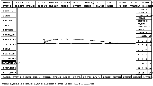

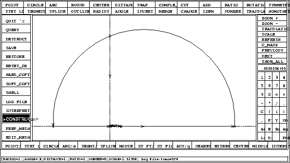

The parametrization of the naca0012 is
To normalize the naca0012, we use the change of variables:
PROGRAM NACA12
DOUBLE PRECISION X,Y,C,XX,YY
PARAMETER (C=1.008930411365D0)
INTEGER NB,I
C -------- ENTER THE NUMBER OF INTERVALS -----------
READ *,NB
DO I=0,NB
C -----------------------------------------------------
C 4 |
C WE USE X INSTEAD OF X SO THAT THE PROGRESSION |
C OF GENERATED POINTS IS DENSER AROUND O |
XX= (DBLE(I)/DBLE(NB))**4
X = C*XX
Y = 5*.12*( 0.2969*SQRT(X) -0.126*X
+ -0.3516*X**2 +0.2843*X**3 -0.1015*X**4)
YY = Y / C
PRINT*, XX,YY
ENDDO
END
We generate the file "naca12.21pts" by using this program with 20 intervals.
The file "naca12.21pts":
0.0000000000000000 0.0000000000000000 6.2500000000000000E-06 4.4290213310617220E-04 1.0000000000000000E-04 1.7659364374154260E-03 5.0625000000000000E-04 3.9520447457293480E-03 1.6000000000000000E-03 6.9724900930098020E-03 3.9062500000000000E-03 1.0785816129632120E-02 8.1000000000000000E-03 1.5335254409279880E-02 1.5006250000000000E-02 2.0543538719326360E-02 2.5600000000000000E-02 2.6304013971036800E-02 4.1006250000000000E-02 3.2467169756843240E-02 6.2500000000000000E-02 3.8822480697810590E-02 9.1506250000000000E-02 4.5076893778196040E-02 0.1296000000000000 5.0833559338836810E-02 0.1785062500000000 5.5577241169031020E-02 0.2401000000000000 5.8675384962268570E-02 0.3164062500000000 5.9403968668221290E-02 0.4096000000000000 5.7000809116986590E-02 0.5220062500000000 5.0728415111155510E-02 0.6561000000000000 3.9881091560527040E-02 0.8145062500000000 2.3576580331835940E-02 1.000000000000000 2.0060198232592660E-14
Figure 1.36: The complete geometry of the naca0012 and infinity

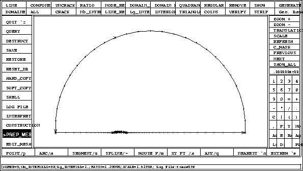

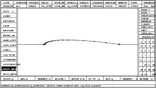

We switch to the PREP_MESH application to define the discretization of the contours.
Figure 1.38: A view of the discretization of all contours
Figure 1.39: Zoom on the discretization of the contours around the naca

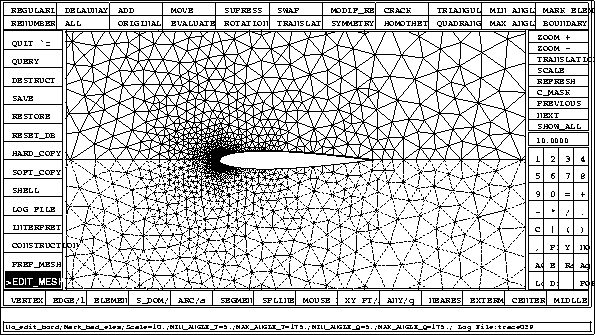

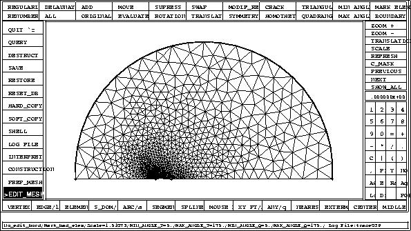

We generate the mesh by switching to the EDIT_MESH application.
Figure 1.40: Mesh around the half naca0012

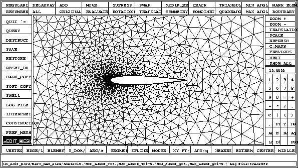

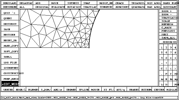

To obtain a complete mesh, we make it symmetrical. First we change point of view to see the whole naca.
Figure 1.42: Zoom 10 on the symmetric mesh of the naca0012
