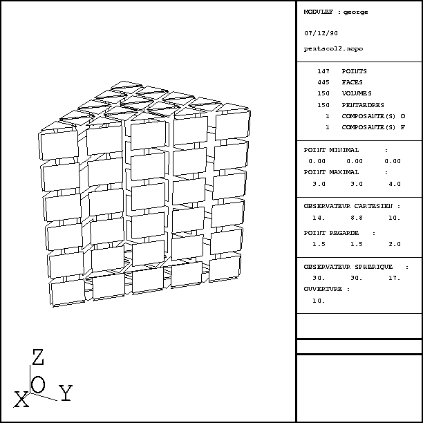

The calling program of COLIB2, for a pentahedral element, is given below. Figure 3.3 shows
the mesh obtained for
and
, where
and
designate the number of points on the edges of the
triangular faces and the number of these points on the other edges, respectively.
C ++++++++++++++++++++++++++++++++++++++++++++++
C TEST COLIBR ( COLIB2 WITH DATA FILE )
C ( A 2 DIMENSIONAL EXAMPLE )
PARAMETER ( LM = 300000 )
COMMON M(LM)
C
IMPRE = -2
NNN = 0
CALL INITIS(M,LM,IMPRE,NNN)
NFNOPO = 10
CALL TRUNIT (NFNOPO)
CALL OUVRIS(NFNOPO,'tunnel.nopo','UNKNOWN,UNFORMATTED',2000000)
C
NFDATA = 11
CALL TRUNIT (NFDATA)
CALL OUVRIS(NFDATA,'tunnel.data','UNKNOWN,FORMATTED',2000000)
C
CALL LECTEU(NFDATA)
CALL COLIBR(M,NFNOPO,NINOPO)
STOP
END
Figure 3.3: Mesh of a pentahedron via COLIB2

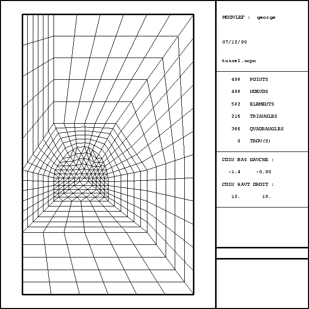

The calling program for COLIBR is shown below for the case corresponding to a 2D mesh construction from 17 triangular and quadrilateral blocks. The resulting mesh is shown in figure 3.4.
COMMON M(LM)
C
IMPRE = -2
NNN = 0
NFNOPO = 10
C
NFDATA = 11
C
CALL LECTEU(NFDATA)
STOP
END
The data file required is the following:
$ NBS NA NBGRO IMPRE NBFR NDIM $
19 35 17 2 0 2
$ NOP NOREF X Y Z ? $
1 1 0.000000E+00 0.000000E+00 0.000000E+00
2 2 0.110000E+02 0.000000E+00 0.000000E+00
3 3 0.110000E+02 0.900000E+01 0.000000E+00
4 4 0.110000E+02 0.180000E+02 0.000000E+00
5 5 0.200000E+01 0.180000E+02 0.000000E+00
6 6 0.000000E+00 0.180000E+02 0.000000E+00
7 7 0.000000E+00 0.400000E+01 0.000000E+00
8 8 0.800000E+01 0.400000E+01 0.000000E+00
9 9 0.800000E+01 0.800000E+01 0.000000E+00
10 10 0.600000E+01 0.110000E+02 0.000000E+00
11 11 0.200000E+01 0.110000E+02 0.000000E+00
12 12 0.000000E+00 0.800000E+01 0.000000E+00
13 13 0.200000E+01 0.600000E+01 0.000000E+00
14 14 0.550000E+01 0.600000E+01 0.000000E+00
15 15 0.550000E+01 0.750000E+01 0.000000E+00
16 16 0.490000E+01 0.900000E+01 0.000000E+00
17 17 0.290000E+01 0.910000E+01 0.000000E+00
18 18 0.200000E+01 0.750000E+01 0.000000E+00
19 19 0.400000E+01 0.750000E+01 0.000000E+00
$ NA IEX1 IEX2 IDEC NP NOREF $
1 1 2 0 5 1
2 2 3 0 5 1
3 3 4 0 5 1
4 4 5 0 5 1
5 5 6 0 5 1
6 6 12 0 4 1
7 12 7 0 5 2
8 7 1 0 4 1
9 7 8 0 5 2
10 8 2 0 4 0
11 8 9 0 5 2
12 9 10 0 5 2
13 9 3 0 4 0
14 10 4 0 4 0
15 10 11 0 5 2
16 12 11 0 5 2
17 11 5 0 4 0
18 13 7 0 5 0
19 14 8 0 5 0
20 15 9 0 5 0
21 16 10 0 5 0
22 17 11 0 5 0
23 18 12 0 5 0
24 13 14 0 5 3
25 14 15 0 5 3
26 15 16 1 5 3
5.45 7.75 0.
5.4 8. 0.
5.3 8.25 0.
5.2 8.50 0.
5.1 8.75 0.
27 16 17 1 5 3
4.5 9.3 0.
4.25 9.45 0.
4.0 9.5 0.
3.5 9.45 0.
3.25 9.3 0.
28 17 18 1 5 3
2.60 8.75 0.
2.40 8.50 0.
2.25 8.25 0.
2.10 8.0 0.
2.05 7.75 0.
29 18 13 0 5 3
30 19 13 0 5 0
31 19 14 0 5 0
32 19 15 0 5 0
33 19 16 0 5 0
34 19 17 0 5 0
35 19 18 0 5 0
$ COARSE ELEMENTS $
$ I NCGE VERTICES NCGE NDSD $
1 4 1 2 8 7 4 1
2 4 2 3 9 8 4 1
3 4 3 4 10 9 4 1
4 4 10 4 5 11 4 1
5 4 11 5 6 12 4 1
6 4 7 13 18 12 4 2
7 4 7 8 14 13 4 2
8 4 8 14 15 9 4 2
9 4 15 9 10 16 4 2
10 4 16 10 11 17 4 2
11 4 18 17 11 12 4 2
12 3 13 14 19 3 3
13 3 14 15 19 3 3
14 3 15 16 19 3 3
15 3 16 17 19 3 3
16 3 19 18 17 3 3
17 3 13 19 18 3 3
Figure 3.4: 2D mesh via COLIBR

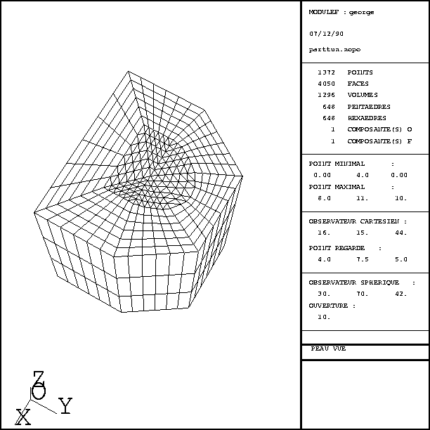

The calling program for COLIBR is given below for the case corresponding to the construction of a 3D mesh from 12 pentahedral and hexahedral blocks. The resulting mesh is shown in figure 3.5.
C ( A 3 DIMENSIONAL EXAMPLE )
COMMON M(LM)
C
IMPRE = -2
NNN = 0
NFNOPO = 10
CALL OUVRIS(NFNOPO,'parttun.nopo','UNKNOWN,UNFORMATTED',2000000)
C
NFDATA = 11
CALL OUVRIS(NFDATA,'parttun.data','UNKNOWN,FORMATTED',2000000)
C
CALL LECTEU(NFDATA)
STOP
END
26 61 12 2 0 3
1 7 0.000000E+00 0.400000E+01 0.000000E+00
2 8 0.800000E+01 0.400000E+01 0.000000E+00
3 9 0.800000E+01 0.800000E+01 0.000000E+00
4 10 0.600000E+01 0.110000E+02 0.000000E+00
5 11 0.200000E+01 0.110000E+02 0.000000E+00
6 12 0.000000E+00 0.800000E+01 0.000000E+00
7 13 0.200000E+01 0.600000E+01 0.000000E+00
8 14 0.550000E+01 0.600000E+01 0.000000E+00
9 15 0.550000E+01 0.750000E+01 0.000000E+00
10 16 0.490000E+01 0.900000E+01 0.000000E+00
11 17 0.290000E+01 0.910000E+01 0.000000E+00
12 18 0.200000E+01 0.750000E+01 0.000000E+00
13 19 0.400000E+01 0.750000E+01 0.000000E+00
14 7 0.000000E+00 0.400000E+01 1.000000E+01
15 8 0.800000E+01 0.400000E+01 1.000000E+01
16 9 0.800000E+01 0.800000E+01 1.000000E+01
17 10 0.600000E+01 0.110000E+02 1.000000E+01
18 11 0.200000E+01 0.110000E+02 1.000000E+01
19 12 0.000000E+00 0.800000E+01 1.000000E+01
20 13 0.200000E+01 0.600000E+01 1.000000E+01
21 14 0.550000E+01 0.600000E+01 1.000000E+01
22 15 0.550000E+01 0.750000E+01 1.000000E+01
23 16 0.490000E+01 0.900000E+01 1.000000E+01
24 17 0.290000E+01 0.910000E+01 1.000000E+01
25 18 0.200000E+01 0.750000E+01 1.000000E+01
26 19 0.400000E+01 0.750000E+01 1.000000E+01
1 6 1 0 5 2
2 1 2 0 5 2
3 2 3 0 5 2
4 3 4 0 5 2
5 4 5 0 5 2
6 6 5 0 5 2
7 7 1 0 5 0
8 8 2 0 5 0
9 9 3 0 5 0
10 10 4 0 5 0
11 11 5 0 5 0
12 12 6 0 5 0
13 7 8 0 5 3
14 8 9 0 5 3
15 9 10 1 5 3
5.45 7.75 0.
5.4 8. 0.
5.3 8.25 0.
5.2 8.50 0.
5.1 8.75 0.
16 10 11 1 5 3
4.5 9.3 0.
4.25 9.45 0.
4.0 9.5 0.
3.5 9.45 0.
3.25 9.3 0.
17 11 12 1 5 3
2.60 8.75 0.
2.40 8.50 0.
2.25 8.25 0.
2.10 8.0 0.
2.05 7.75 0.
18 12 7 0 5 3
19 13 7 0 5 0
20 13 8 0 5 0
21 13 9 0 5 0
22 13 10 0 5 0
23 13 11 0 5 0
24 13 12 0 5 0
25 19 14 0 5 2
26 14 15 0 5 2
27 15 16 0 5 2
28 16 17 0 5 2
29 17 18 0 5 2
30 19 18 0 5 2
31 20 14 0 5 0
32 21 15 0 5 0
33 22 16 0 5 0
34 23 17 0 5 0
35 24 18 0 5 0
36 25 19 0 5 0
37 20 21 0 5 3
38 21 22 0 5 3
39 22 23 1 5 3
5.45 7.75 10.
5.4 8. 10.
5.3 8.25 10.
5.2 8.50 10.
5.1 8.75 10.
40 23 24 1 5 3
4.5 9.3 10.
4.25 9.45 10.
4.0 9.5 10.
3.5 9.45 10.
3.25 9.3 10.
41 24 25 1 5 3
2.60 8.75 10.
2.40 8.50 10.
2.25 8.25 10.
2.10 8.0 10.
2.05 7.75 10.
42 25 20 0 5 3
43 26 20 0 5 0
44 26 21 0 5 0
45 26 22 0 5 0
46 26 23 0 5 0
47 26 24 0 5 0
48 26 25 0 5 0
49 1 14 0 2 0
50 2 15 0 2 0
51 3 16 0 2 0
52 4 17 0 2 0
53 5 18 0 2 0
54 6 19 0 2 0
55 7 20 0 2 0
56 8 21 0 2 0
57 9 22 0 2 0
58 10 23 0 2 0
59 11 24 0 2 0
60 12 25 0 2 0
61 13 26 0 2 0
$ COARSE ELEMENTS $
1 7 1 2 8 7 14 15 21 20 7 1
2 7 2 3 9 8 15 16 22 21 7 1
3 7 3 4 10 9 16 17 23 22 7 1
4 7 10 11 5 4 23 24 18 17 7 1
5 7 5 6 12 11 18 19 25 24 7 1
6 7 1 7 12 6 14 20 25 19 7 1
7 6 7 8 13 20 21 26 6 2
8 6 8 13 9 21 26 22 6 2
9 6 13 9 10 26 22 23 6 2
10 6 13 10 11 26 23 24 6 2
11 6 13 11 12 26 24 25 6 2
12 6 7 13 12 20 26 25 6 2
Figure 3.5: 3D mesh via COLIBR

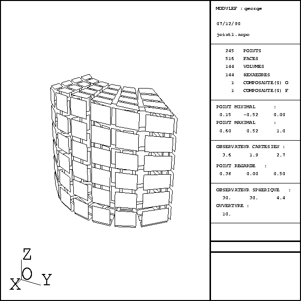

The following example illustrates the utilization of COLIBH for the case where the data is calculated, in the program, from a reduced set of parameters. The calling program of the module, which uses 2 subroutines, is given below, followed by a plot of the resulting mesh in figure 3.6.
C TEST COLIBH ( COLIB2 WITH A SINGLE HEXAHEDRA )
C ----------- EXAMPLE OF THE JUNCTION ( PART 1 )
COMMON M(LM)
INTEGER IDECAR(12),NBPARE(12)
REAL XYZ(3,8),XYZINT(3,200)
C
IMPRE = 3
NNN = 0
C --- THE O.D.S. NOPO ---
NFNOPO = 10
NINOPO = 0
CALL OUVRIS(NFNOPO,'joint1.nopo','UNKNOWN,UNFORMATTED',2000000)
C --- THE REFERENCES AND THE SUB-DOMAIN ---
NDSDE = 1
IREF = 1
C ------------------------
C --- THE GEOMETRY ---
DO 1 I=1,3
DO 1 J=1,8
XYZ(I,J) = 0.
1 CONTINUE
C --- THE DEFINITION PARAMETERS :
RPI = 3.14159265
A30 = 30. * RPI / 180.
S30 = SIN(A30)
C30 = COS(A30)
R03 = 0.3
X03 = 0.
Y03 = 0.
R06 = 0.6
X06 = 0.
Y06 = 0.
BB = 1.2
C --- THE BASIS :
XYZ(1,1) = R06 * S30
XYZ(1,2) = R06 * S30
XYZ(1,3) = R03 * S30
XYZ(1,4) = R03 * S30
XYZ(2,1) = - R06 * C30
XYZ(2,2) = R06 * C30
XYZ(2,3) = R03 * C30
XYZ(2,4) = - R03 * C30
C --- THE TOP :
DO 2 I=1,2
DO 2 J=1,4
XYZ(I,J+4) = XYZ(I,J)
2 CONTINUE
DO 3 J=1,4
AA = 1.0 + 0.3 * XYZ(1,J) / 1.7
CALL SPELLI(AA,BB,XYZ(2,J+4),XYZ(3,J+4))
3 CONTINUE
C --- THE SIDES :
NPI = 5
DO 4 J=1,12
NBPARE(J) = NPI
IDECAR(J) = 0
4 CONTINUE
NBPARE(2) = 3
NBPARE(4) = 3
NBPARE(10) = 3
NBPARE(12) = 3
C
IDECAR(1) = 1
IDECAR(3) = 1
IDECAR(9) = 1
IDECAR(11) = 1
C --- THE INTERMEDIARY POINTS :
C EDGE 1 :
IEX11 = 1
IEX21 = 2
D1 = ( XYZ(2,IEX21) - XYZ(2,IEX11) ) / ( NPI + 1. )
C EDGE 3 :
IEX13 = 3
IEX23 = 4
D3 = ( XYZ(2,IEX23) - XYZ(2,IEX13) ) / ( NPI + 1. )
C Y
DO 5 J=1,NPI
XYZINT(2,J) = XYZ(2,IEX11) + J * D1
XYZINT(2,J+NPI) = XYZ(2,IEX13) + J * D3
5 CONTINUE
C X = FUNCTION OF Y
DO 6 J=1,NPI
CALL SPCERC(R06,X06,Y06,XYZINT(2,J),XYZINT(1,J))
CALL SPCERC(R03,X03,Y03,XYZINT(2,J+NPI),XYZINT(1,J+NPI))
6 CONTINUE
C SUPPORT ON THE EDGES 9 AND 11 :
DO 7 J=1,NPI
XYZINT(1,J+2*NPI) = XYZINT(1,J)
XYZINT(1,J+3*NPI) = XYZINT(1,J+NPI)
XYZINT(2,J+2*NPI) = XYZINT(2,J)
XYZINT(2,J+3*NPI) = XYZINT(2,J+NPI)
7 CONTINUE
C Z
DO 8 J=1,4*NPI
XYZINT(3,J) = 0.
8 CONTINUE
C Z ( EDGES 9 AND 11 )
DO 9 J=1,2*NPI
AA = 1.0 + 0.3 * XYZINT(1,J+2*NPI) / 1.7
CALL SPELLI(AA,BB,XYZINT(2,J+2*NPI),XYZINT(3,J+2*NPI))

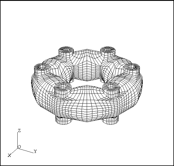

The following example results from several calls to COLIBH, gluing the meshes obtained together, and different geometric manipulations of the latter (symmetries, rotations, etc., and a final gluing together).
Figure 3.7: Mesh of a junction via COLIBH and geometric transformations
