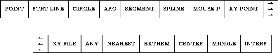

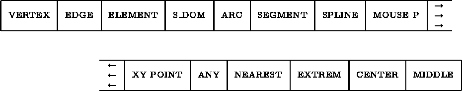

These menus, shown at the bottom of the graphics window, make it possible to select the type of graphics selection we want (a point, a straight line, etc.). They depend on the application currently being used (cf. figures 1.18, 1.19, 1.20). It is absolutely essential to understand the outputs of these menus because all the rest depends on their functioning. All these outputs, for example, a circle, a number or the extremity of an arc, are marked (?) and the marks (or types ?) define the selection syntactical entities known by the grammars which manage the three applications.

These menus depend on the application being used as they define the type of element to be selected. The menu ITEMs (their keyboard shortcut is in parenthesis) can be classified in several categories.
SPLINE (~)
are used to select the element of the DB
closest to the clicked point, the type of selection
depends on the kind of element found and by the item in categories
(4), (5) that is used. If there is an incompatibility,
the item in category (4) is forced to change to(?) NEAREST.
n)item is used to
effectively select an element of the DB and the type of selection is that of
the element.

The selections possible depend on the application since all types of selection are not always needed. For example, circles and straight lines are only used in the CONSTRUCTION application, elements, edges, vertices and subdomains only exist in the EDIT_MESH application.

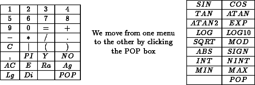

This menu (cf. figure 1.21) can also be considered as a selection menu. It can be used to define a numerical value which is of type <VALUE> .
Figure 1.21: The two calculator menus
We can write any FORTRAN expression. The effective computation is achieved by clicking on the = box (shortcut =) or by typing (CR) .

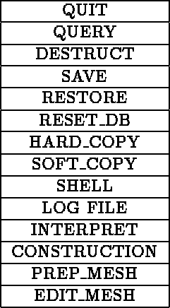

This menu (cf. figure 1.22) is used to perform general operations: move between CONSTRUCTION, PREP_MESH and EDIT_MESH, save, restore, screen copy or execute a system command. To initiate an operation, click in the corresponding item.
The operations of the general menu are:
QUIT
Terminates the execution of the program.
QUERY
Queries the selected elements. Their characteristics are displayed in the input-output or scratch zone.
DESTRUCT
Only available in the CONSTRUCTION application. Destructs selected elements of the database. Warning: if we destruct a POINT, the program checks if this POINT is used to define a SPLINE. If this is the case, it is also removed from the SPLINE.
SAVE
Saves the DB in a file. The name of the file is composed a prefix and a suffix. The system asks for the prefix in the scratch zone (figure 1.9). According to the case, the suffix can be .emc2_bd, .mesh, .nopo, .am, .am_fmt, .amdba and it depends on the current application:
RESTORE
Restores the DB of a file. The name of the file is composed of a prefix and a suffix. The system asks for the prefix in the scratch zone (figure 1.9). According to the case, the suffix can be .emc2_bd, .mesh, .nopo, .am, .am_fmt, .amdba. The data restored depend on the current application.
Caution: The recently read mesh is not merged with already existing meshes.
DB_RESET
Clears everything stored in the 2 databases.
HARD_COPY
Makes a bitmap, screen resolution, hard copy of the screen. Depends on the system and on the environment (cf. hardcp subroutine).
SOFT_COPY
Displays the screen on another Fortran 3d peripheral device. Depends on the system and on the environment (cf. softcp subroutine)
SHELL
Executes a system command (shell). The system asks for the the command(s) in a character string. Depends on the system (cf. exec subroutine).
LOG FILE
Saves all user operations in a file. The file name is composed of prefix given by the user and the suffix .trace_emc2. If the prefix starts with a + sign, it is appended to the trace file. A default trace file is open. Its prefix is tracexxxx, where xxxx is a version number in order not to erase the previous trace.
INTERPRET
Interprets a trace file. The prefix is given by the user.
CONSTRUCTION
Moves to the CONSTRUCTION application. After the move, the selection mode is MOUSE P.
PREP_MESH
Moves to the PREP_MESH application. After the move, the selection mode is MOUSE P.
EDIT_MESH
Moves to the EDIT_MESH application. When the move occurs and after the 4 questions have been answered, the program triangulates all the defined domains. If no domain has been defined, everything is meshed. The triangulation depends on 4 parameters. To get the default value, type (CR)
for each parameter.
. coef = .75 is the default
value.
