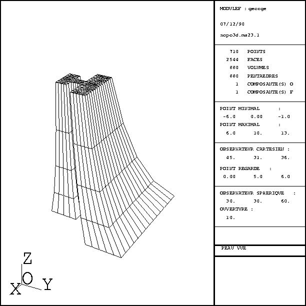

The calling programs, the output obtained during execution of case 1, and a plot of the resulting mesh (figure 3.14) is shown below.
Definition via MAT (TTYPE = -1):

Figure 3.14:  Example  MA2D3E (step-by-step definition via MAT or XYZ23)
 M   M    OOO    DDDD    U   U   L       EEEEE   FFFFF
 MM MM   O   O   D   D   U   U   L       E       F
 M M M   O   O   D   D   U   U   L       EEEE    FFFF
 M   M   O   O   D   D   U   U   L       E       F
 M   M    OOO    DDDD     UUU    LLLLL   EEEEE   F      VERSION 91
 DATE   : 16/10/91
 AUTHOR : dutoit
 ++ OPEN(10,FILE='nopo2d.ma23.2',SPEC='OLD,UNFORMATTED',RECL=0)
 ++ OPEN(11,FILE='nopo3d.ma23.1',SPEC='UNFORMATTED',RECL=0)
 MODULE MA2D3E :
 HEIGHT OF THE BOTTOM BASIS :  -0.1000000E+01
 NUMBER OF GEOMETRIC TRANSFORMATIONS :      4
 LIST OF TRANSFORMATIONS :
    SECTION      0 A      1 TYPE OF TRANSFORMATION     -1
    SECTION      1 A      2 TYPE OF TRANSFORMATION     -1
    SECTION      2 A      3 TYPE OF TRANSFORMATION     -1
    SECTION      3 A      4 TYPE OF TRANSFORMATION     -1
 NUMBER OF TRANSFERS OF NUMBERS       :      2
 LIST OF TRANSFERS      :
    SECTION      0 A      0 TYPE OF TRANSFER           0 :   -100 GIVES      1
    SECTION      9 A      9 TYPE OF TRANSFER           0 :   -100 GIVES      2
 MESH OBTAINED : SAVE D.S.
 TABLE  N O P 2
 MESH CHARACTERISTICS :
 SPACE DIMENSION                        (NDIM ) :      3
 MAXIMUM NUMBER OF REFERENCES           (NDSR ) :      1
 MAXIMUM NUMBER OF SUB-DOMAINS          (NDSD ) :      1
 NODES AND POINTS COINCIDE             (NCOPNP) :      1
 NUMBER OF ELEMENTS                     (NE   ) :    880
 NUMBER OF PENTAHEDRA                   (NPENT) :    880
 NUMBER OF BOUNDARY ELEMENTS            (NEF  ) :     72
 NUMBER OF NODES                        (NOE  ) :    710
 NUMBER OF NODES PER SEGMENT (NO EXTREMITIES)   :      0
 TYPE OF COORDINATE VALUES             (NTYCOO) : REEL1MOT
 MAX DIFFERENCE +1 BETWEEN 2 NODES OF AN ELEMENT :   271
 NUMBER OF COARSE ELEMENTS             (NBEGM ) :      0
 NUMBER OF WORDS IN ARRAY NOP5         (LNOP5 ) :  13420
 REFERENCE AXIS    X,Y,Z               (NTACOO) :      1
 END OF MODULE MA2D3E

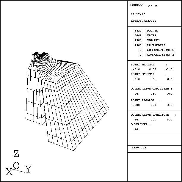

An example with TTYPE = -3 for sections 5 to 9 and TTYPE = -6 for the first sections. Consequently, we have:
The calling program, the output obtained during execution and a plot of the resulting mesh is shown below.

      SUBROUTINE XYZ33(I,NUM,NREF,X,Y,Z,X3,Y3,Z3)
C
      X3 = 0.10 * I * X
      Y3 = 0.10 * I * Y
      Z3 = Z + 0.450
      END
C   +++++++++++++++++++++++++++++++++++++++++++++++++++++++++++++++++++
C    SUBROUTINE XYZ23
      SUBROUTINE XYZ23(I,NUM,NREF,X,Y,Z,X3,Y3,Z3)
C
      X3 = X / 2.5
      Y3 = Y / 2.5
      Z3 = 10.
      END
Figure 3.15:  Example  MA2D3E (an interpolation followed by step-by-step definitions)
 DATE   : 16/10/91
 AUTHOR : dutoit
 MODULE MA2D3E :
    SECTION      0 TO     5 TYPE OF TRANSFORMATION     -6
    SECTION      5 TO     9 TYPE OF TRANSFORMATION     -3
 LIST OF TRANSFERS      :
    SECTION      0 TO     0 TYPE OF TRANSFER           0 :   -100 GIVES      1
    SECTION      9 TO     9 TYPE OF TRANSFER           0 :   -100 GIVES      2
 TABLE  N O P 2
 NUMBER OF ELEMENTS                     (NE   ) :   1980
 NUMBER OF PENTAHEDRA                   (NPENT) :   1980
 NUMBER OF NODES                        (NOE  ) :   1420
 NUMBER OF WORDS IN ARRAY NOP5         (LNOP5 ) :  29040

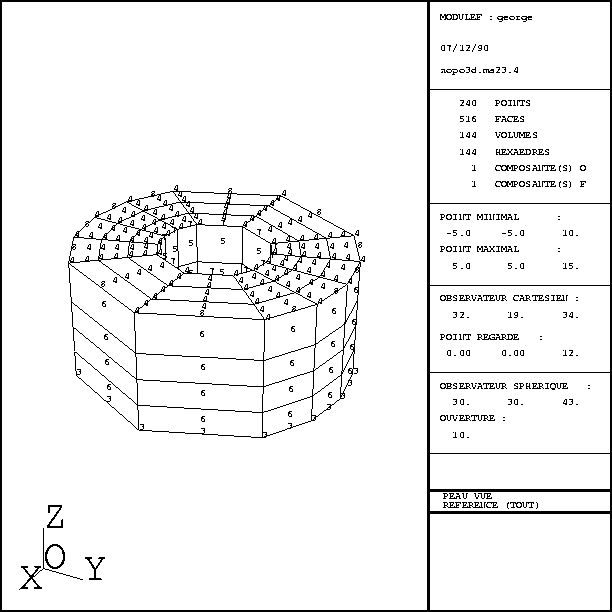

An example with TTYPE = -4, i.e., starting from the 2D mesh data (a ring with reference 1 for the items of the internal circle and reference 2 for the external circle), we define the basis via ZINT(0) = 10. and construct sections 1 to 4 of the sides given in array ZINT(1:4) by translation.
The references of the 3D mesh are attributed via array DESREF(.,.) (see the calling program for the specification of the transfers and figure 3.16 for the result obtained.

C     -----------------------------------------------
C     ------  GEOMETRICAL TRANSFORMATIONS      ------
C     ---   The BASIS :
      BFONC   = .FALSE.
      ZINT(0) = 10.
C     ---   THE INTERMEDIARY SIDES :
      NBCOU   = 4
      ZINT(1) = 11.
      ZINT(2) = 12.
      ZINT(3) = 13.
      ZINT(4) = 14.5
C     ---   A FUNCTION : A MANUAL TRANSLATION
      NBFONC = 1
C
      IFONC  = 1
      NUCOU(1,IFONC) = 0
      NUCOU(2,IFONC) = 4
      NUCOU(3,IFONC) = -4
C     ------   DEFINITION OF THE REFERENCES       ------
      NBDES = 6
C     ---   BASIS : FACES EDGES AND POINTS SET TO REFERENCE 3 :
      IDES = 1
      DESREF(1,IDES) = 0
      DESREF(2,IDES) = 0
      DESREF(3,IDES) = 0
      DESREF(4,IDES) = -100
      DESREF(5,IDES) = 3
C     ---
C     ---   ABOVE : FACES EDGES AND POINTS SET TO REFERENCE 4 :
C           ABOVE : THEN EDGE 1 (2D) ==> EDGE 7 (3D)
C           ABOVE : THEN EDGE 2 (2D) ==> EDGE 8 (3D)
      IDES = 2
      DESREF(1,IDES) = 4
      DESREF(2,IDES) = 4
      DESREF(3,IDES) = 0
      DESREF(5,IDES) = 4
      IDES = 3
      DESREF(1,IDES) = 4
      DESREF(2,IDES) = 4
      DESREF(3,IDES) = 4
      DESREF(4,IDES) = 1
      DESREF(5,IDES) = 7
      IDES = 4
      DESREF(1,IDES) = 4
      DESREF(2,IDES) = 4
      DESREF(3,IDES) = 4
      DESREF(4,IDES) = 2
      DESREF(5,IDES) = 8
C     ---   VERTICAL FACES : EDGE 1 (2D) ==> FACE 5 (3D)
C                            EDGE 2 (2D) ==> FACE 6 (3D)
      IDES = 5
      DESREF(1,IDES) = 0
      DESREF(2,IDES) = 4
      DESREF(3,IDES) = 3
      DESREF(4,IDES) = 1
      DESREF(5,IDES) = 5
      IDES = 6
      DESREF(1,IDES) = 0
      DESREF(2,IDES) = 4
      DESREF(3,IDES) = 3
      DESREF(4,IDES) = 2
      DESREF(5,IDES) = 6
C     ------   CALL THE MODULE                 ------
      EPS    = 0.001
      COLLER = .FALSE.
      RAPIDE = .TRUE.
C
      CALL MA2D3E(M,M,NFNOPO,NINOPO,NFNOPS,NINOPS,NBCOU,EPS,NBFONC,
     +            NUCOU,MAT,COLLER,RAPIDE,DESREF,NBDES,ZINT,BFONC,
     +            XYZ23,XYZ33)
      END
Figure 3.16:  Example  MA2D3E (translation)
 DATE   : 16/10/91
 AUTHOR : dutoit
 ++ OPEN(10,FILE='nopo2d.ma23.1',SPEC='OLD,UNFORMATTED',RECL=0)
 ++ OPEN(11,FILE='nopo3d.ma23.4',SPEC='UNFORMATTED',RECL=0)
 MODULE MA2D3E :
 HEIGHT OF THE BOTTOM BASIS :   0.1000000E+02
 NUMBER OF GEOMETRIC TRANSFORMATIONS :      1
    SECTION      0 TO      4 TYPE OF TRANSFORMATION     -4
 NUMBER OF NUMBER TRANSFERS           :      6
 LIST OF TRANSFERS      :
    SECTION      0 TO      0 TYPE OF TRANSFER           0 :   -100 GIVES      3
    SECTION      4 TO      4 TYPE OF TRANSFER           0 :   -100 GIVES      4
    SECTION      4 TO      4 TYPE OF TRANSFER           4 :      1 GIVES      7
    SECTION      4 TO      4 TYPE OF TRANSFER           4 :      2 GIVES      8
    SECTION      0 TO      4 TYPE OF TRANSFER           3 :      1 GIVES      5
    SECTION      0 TO      4 TYPE OF TRANSFER           3 :      2 GIVES      6
 TABLE  N O P 2
 MAXIMUM NUMBER OF REFERENCES           (NDSR ) :      8
 NUMBER OF ELEMENTS IN THE MESH         (NE   ) :    144
 NUMBER OF HEXAHEDRA                    (NHEX ) :    144
 NUMBER OF BOUNDARY ELEMENTS            (NEF  ) :     28
 NUMBER OF NODES                        (NOE  ) :    240
 MAX DIFFERENCE +1 BETWEEN 2 NODES OF AN ELEMENT :    78
 NUMBER OF WORDS IN ARRAY NOP5         (LNOP5 ) :   4968

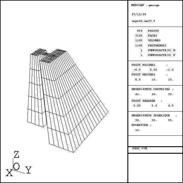

An example with TTYPE = -5, i.e., definition of the upper basis (via XYZ23 at side Z=10.) and interpolation between the basis (ZINT(0) = -1.) and this section to construct 5 sections with equidistant sides between that of the basis and that of the upper section.
The references of the 3D mesh are attributed via via array DESREF(.,.) (see the calling program for the specification of the transfers and figure 3.18 for the result obtained).
Extracts of the calling program and a plot of the resulting mesh is shown below.
C     ---   LA BASE :
      BFONC   = .FALSE.
      ZINT(0) = -1.
      NBCOU   = 5
C     ---   A FUNCTION : A MANUAL INTERPOLATION
C           BETWEEN THE BASIS AND THE ONE ABOVE DEFINED BY XYZ23
C           FOR SIDE 10. ( SEE XYZ23 )
      NBFONC = 1
C
      IFONC  = 1
      NUCOU(1,IFONC) = 0
      NUCOU(2,IFONC) = 5
      NUCOU(3,IFONC) = -5
C    SUBROUTINE XYZ23
C
      X3 = X / 2.5
      Y3 = Y / 2.5
      Z3 = 10.
      END
Figure 3.17:  Example  MA2D3E (interpolation equidistant in z)

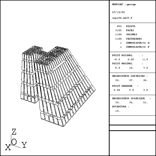

An example with TTYPE = -6, i.e., definition of a virtual upper basis (via XYZ23 at side Z=10.) and interpolation between the basis (ZINT(0) = -1.) and this section to construct 5 sections of sides contained in array ZINT(1:5).
The references of the 3D mesh are attributed via array DESREF(.,.) (see the calling program for the specification of the transfers and figure 3.18 for the result obtained).
The calling program, the output obtained during execution and a plot of the mesh obtained is shown below.
C   EXAMPLE OF CALLING MODULE MA2D3E : TEST NUMBER 6
      PARAMETER (LM = 100000 , MAXFON = 1 , MAXSEC = 9 , MAXDES = 10 )
C     ---   LA BASE :
      BFONC   = .FALSE.
      ZINT(0) = -1.
      NBCOU   = 5
      ZINT(1) = 0.
      ZINT(2) = 2.
      ZINT(3) = 4.
      ZINT(4) = 6.
      ZINT(5) = 7.
      NBFONC = 1
C
      IFONC  = 1
      NUCOU(1,IFONC) = 0
      NUCOU(2,IFONC) = 5
      NUCOU(3,IFONC) = -6
      EPS    = 0.001
      COLLER = .FALSE.
      RAPIDE = .TRUE.
C
