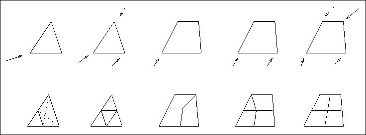

The method is only suitable for the two-dimensional case.
Figure 4.4:  Refinement around vertices
Many situations are possible depending on the type of element, for which at least one point is given in the list of points to treat, and the position of the vertices under consideration (see figure 4.4).
