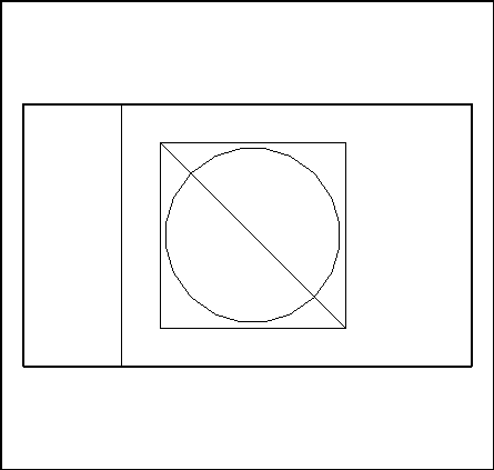

Starting from the "highest" notion, the domain, we distinguished the different useful notions in the preceding section: mesh generators, contours, lines, points. The actual creation of the mesh is performed in the inverse direction, i.e., by starting from the "lowest" notion, the point, in order to define the domain step by step.
Figure 5.2:  The characteristic items
Figure 5.2 indicates the 13 points necessary to define the geometry. The 16 lines used for the construction are also shown. Next, the contours are formed:
The data file is given below:

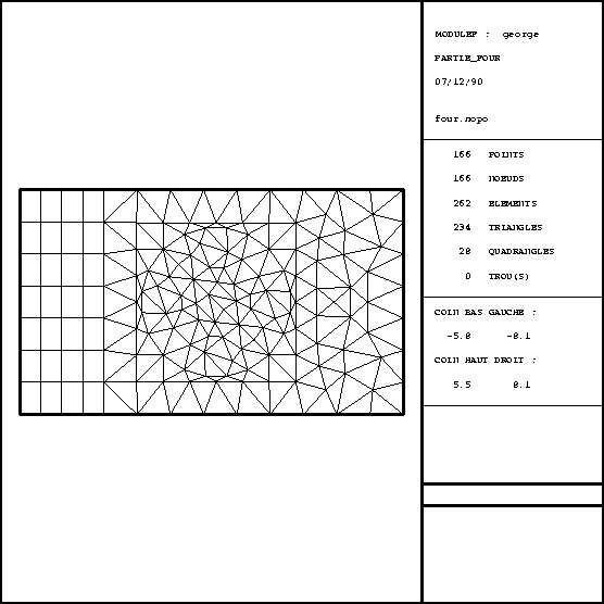

The following listing is obtained during execution of APNOXX:
 EXECUTING APNOPO : ( 2D MESH )
 -- CREATE THE DATA  =-=  EXECUTE MODULE (DATA EXISTING)  =-=  END  =-=  ?
E
 -- NAME OF THE DATA FILE ?
oven.data
 COURBES
 ** PROCESSING OF KEYWORD COUR
 ++ OPEN(11,FILE='',SPEC='SCRATCH,UNFORMATTED',RECL=0)
 POINTS
 ** PROCESSING OF KEYWORD POIN
 LIGNES
 ** PROCESSING OF KEYWORD LIGN
 QUAC
 ** PROCESSING OF KEYWORD QUAC
 MODULE QUACOO : PART_OVEN
 END OF MODULE QUACOO
 TRIH
 ** PROCESSING OF KEYWORD TRIH
 MODULE TRIHER :
 END OF MODULE TRIHER
 TRIH
 MODULE TRIHER :
 TRIH
 MODULE TRIHER :
 RECO
 ** PROCESSING OF KEYWORD RECO
 MODULE RECOLC : PART_OVEN
 FIN DU MODULE RECOLC
 SYMD
 ** PROCESSING OF KEYWORD SYMD
 MODULE MODNOP : PART_OVEN
 END OF MODULE MODNOP
 RECO
 RECO
 RECO
 RENC
 ** PROCESSING OF KEYWORD RENC
 MODULE GIBBS : PART_OVEN
 MODULE RENUM1 : PART_OVEN
 PERMUTATION OF COORDINATES
 RENUMBERING OF NODES
 NUMBER OF NODES :       152
 I CHARACTERISTICS    I BEFORE RENUMBERING  I AFTER RENUMBERING   I
 I BAND WIDTH         I             114     I              15     I
 I TOTAL PROFILE      I            3524     I            1706     I
 I MEAN PROFILE       I              23.184 I              11.224 I
 END OF MODULE RENUM1
 END OF MODULE GIBBS
 SAUV
 ** PROCESSING OF KEYWORD SAUV
 ++ OPEN(12,FILE='oven.nopo',SPEC='UNFORMATTED',RECL=0)
 F
 ** PROCESSING OF KEYWORD F
 END OF MODULE APNOPO
END
