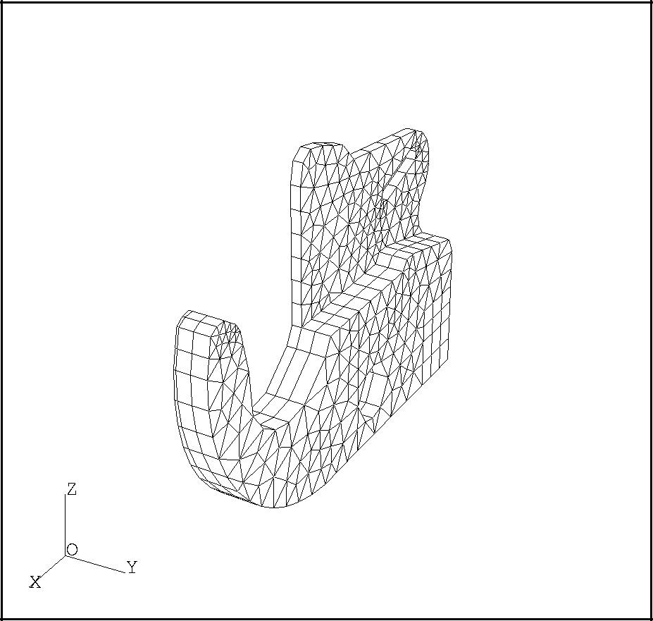

The example chosen is the solution of a realistic linear elasticity problem by the finite element method: a hook, greased on part of its boundary, is submitted to a vertical traction force on the utility part. Given the envisaged boundary conditions, and the material assumed homogeneous isotropic, the problem exhibits a symmetry plane, so that the domain is reduced to a half-hook (see Figure 1).
For more details about the variational formulation of this problem, as well as its finite element approximation and the different aspects of the computer implementation, consult also [1]. Other numerical experiences concerning the solution of this problem are also found in this reference.
During numerical implementation, several distinctive steps appear before the actual solution:
(data structure NOPO)
by module APNOPO,
Consult the corresponding guides for the utilization of these modules.
Figure 1.1: Mesh of the domain
The geometry of the model problem is described by a NOPO data structure, and a view of the object is presented in Figure 1.1. The mesh contains 1006 elements and 937 nodes, the finite elements used being of degree 1.
At each of the nodes, we need to compute the three displacement components, so that the resulting linear system has 2811 unknowns. The structure of the matrix of the linear system is represented in figure 1.2.

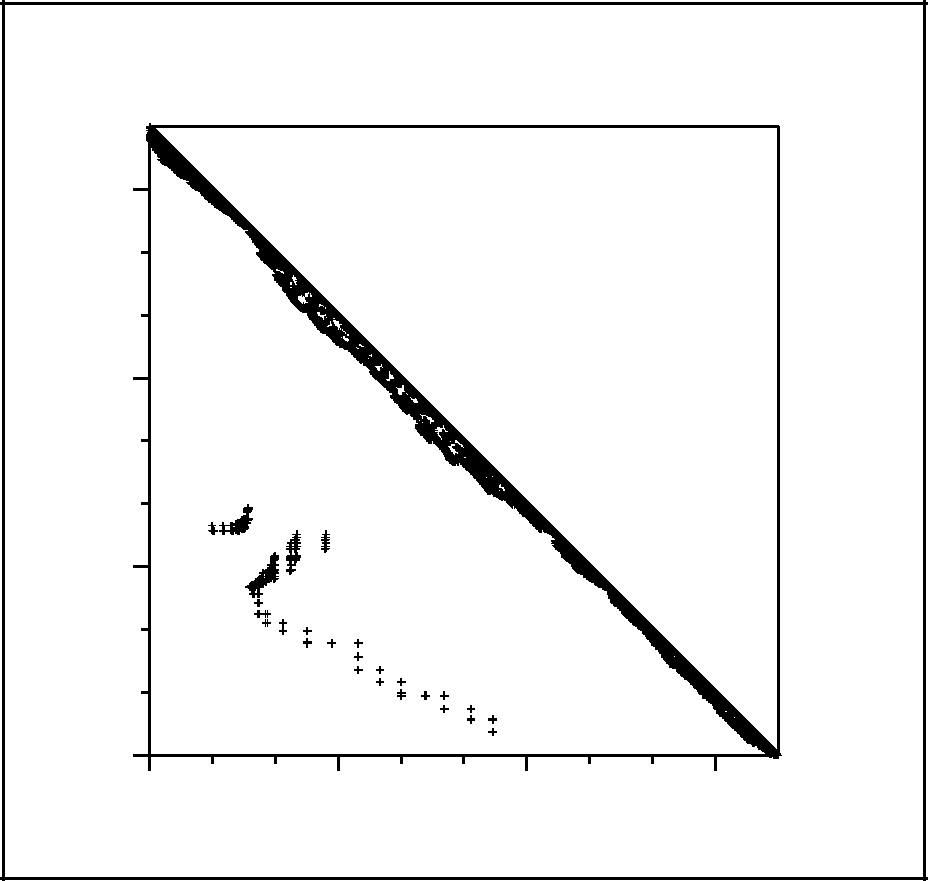

Since the memory space required to store this matrix is quite large, it is advantageous to use module CHOLPS where the matrix is stored in secondary memory. Main program CHOSXX successively calls modules PREPAC, ASMAPS, ASMBMS CHOLPS and, lastly, DRCHPS. The listing of the data of CHOSXX is given below:
crochet.mail $ FILE NAME
1 $ AND LEVEL OF THE D.S. MAIL
1 5 3 $ NDSM NTYP ND
crochet.tae $ FILE NAME
1 $ AND LEVEL OF THE D.S. TAE
1 $ 1 IF BDCL IS USED , 0 IF NOT
crochet.bdcl $ FILE NAME
1 $ AND LEVEL OF THE D.S. BDCL
0 $ 1 IF BOUNDARY CONDITIONS I.T.O.
$ LINEAR RELATIONS EXIST
crochet.mua $ FILE NAME
1 $ AND LEVEL OF THE D.S. MUA
crochet.b $ FILE NAME
4 $ IMPREB
4096 $ LPAGE
