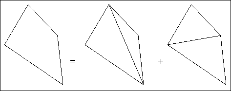

The validity of the repositioning of the points is checked. It is clear that we cannot move a point in an arbitrary fashion; the program checks automatically that the mesh remains correct by calculating the surfaces of the modified elements to ensure that they remain positive.
If the point only belongs to triangles, it suffices to consider their surfaces. If the point belongs to one or several quadrilaterals, the check consists of examining the surfaces of the triangles which could be formed from the 4 vertices of each modified quadrilateral.
Figure 2.1: Checking the displacement of a point

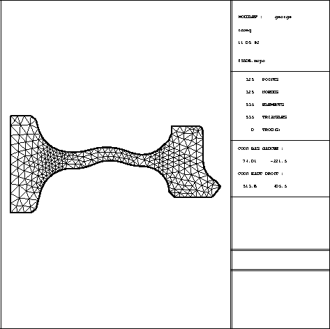

Figure 2.2: Example TRNOXX 2D: automatic mode

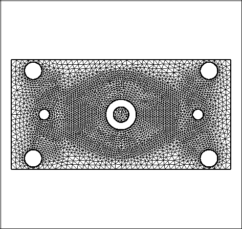

Figure 2.3: Example TRNOXX 2D: automatic mode

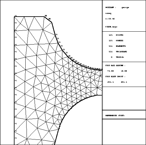

Figure 2.4: Example TRNOXX 2D: zoom, shrink and reference numbers

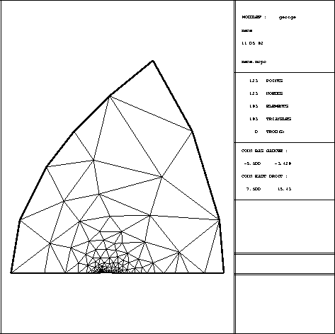

Figure 2.5: Example TRNOXX 2D: automatic mode without legend
