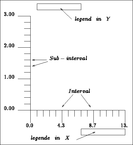

An axis is defined by the following parameters:
Figure 4.1: Automatic division of the x and y axes
These choices are made via the keys described below:

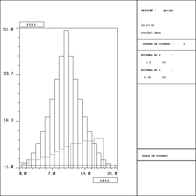

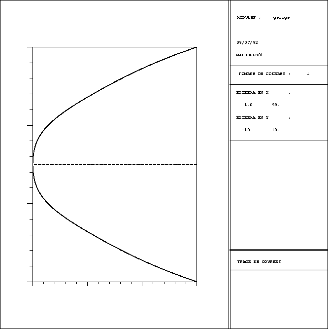

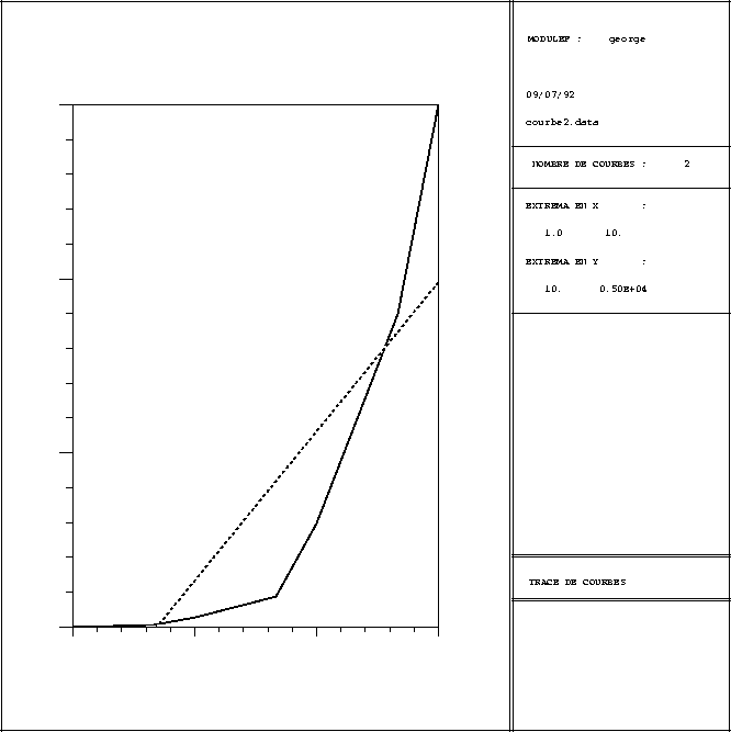

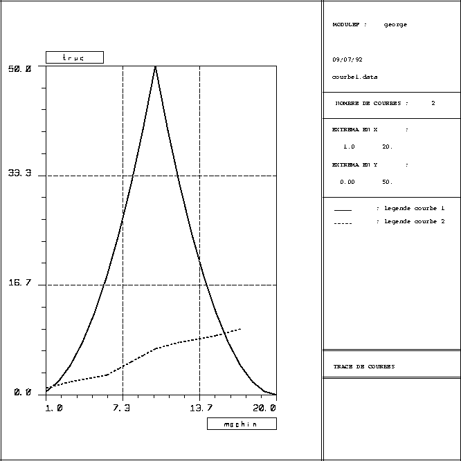

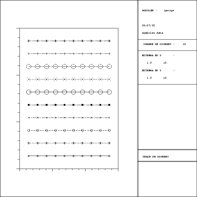

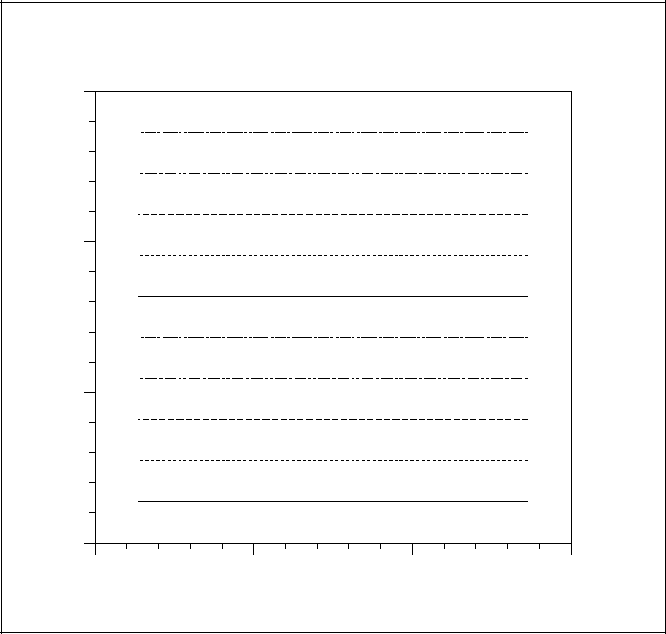

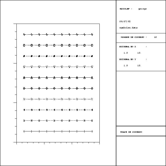

Below follows some application examples of TRACXX. The first two examples, figures 4.2 and 4.3 show, for the case of a plot with lines and symbols, the symbols used in hard and soft. Figures 4.4 and 4.5 show line plots of curves: from the first plot, we chose the standard case (linear scales in x and y), a rough grid, one legend per curve and one legend per axis; for the second plot, we chose a logarithmic scale in y with shading. Figure 4.6 shows a plot without the general legend. Figure 4.7 starts with the plot in figure 4.4 and interprets it in the form of a histogram. Figure 4.8 shows the plot of an analytical function defined in parametric form, whereas figure 4.9 shows a set of points (input via the file of figure 4.5), and its linear interpolation.

Figure 4.2: Example TRACXX: symbols in hard
Figure 4.3: Example TRACXX: symbols in soft
Figure 4.4: Example TRACXX: linear scale

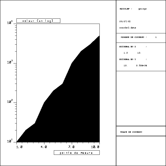

Figure 4.5: Example TRACXX: logarithmic scale in Y (shading)

Figure 4.7: Example TRACXX: histograms
Figure 4.8: Example TRACXX: parametric function
Figure 4.9: Example TRACXX: curve and its interpolation
