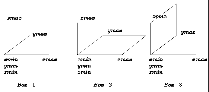

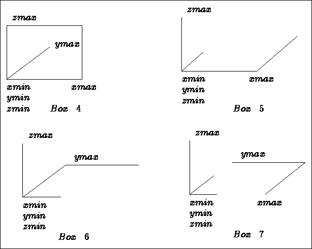

Different manners of generating the "reference-box" (parallelopiped), containing the object to be visualized, are possible.
Figure 5.1: Reference-box 1, 2 and 3
Figure 5.2: Reference-box 4, 5, 6 and 7
The different reference-boxes are shown in figures 5.1 and 5.2 for cases 1 to 7. Reference-box number 0 is the one where we visualize nothing, whereas a reference-box with a negative number corresponds to a complete parallelopiped.
Note that reference-box 2 is the default value.

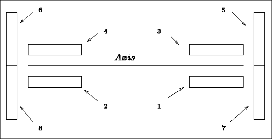

The user must then input the legend corresponding to the axis, specify if he/she would like to frame the legend, as well as specify its position (8 positions are possible, see figure 5.4).
Figure 5.4: Positioning of legends on the axes

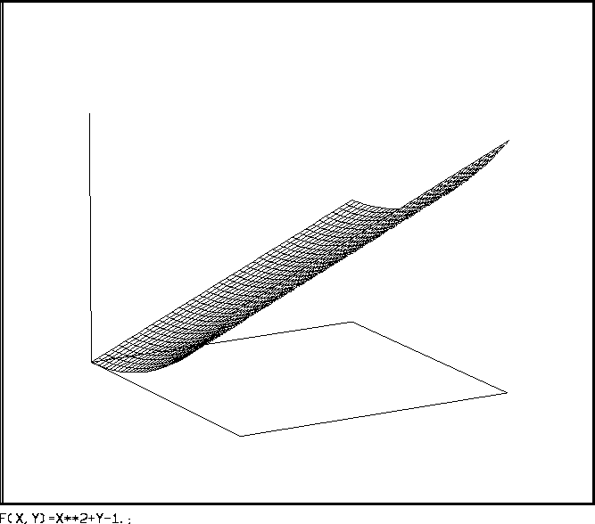

Two examples are shown below:
Figure 5.5: Example VIS3XX: manual definition
Figure 5.6: Example VIS3XX: NOPO and B
