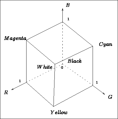

On a color terminal with a cathodic-ray tube, the different colors are obtained by the combination of the three basic colors: RED, GREEN and BLUE (RGB).
RED + GREEN = YELLOW
RED + BLUE = MAGENTA
GREEN + BLUE = CYAN
RED + GREEN + BLUE = WHITE
The intermediary colors are obtained by putting a multiplicative factor, between 0. and 1., with each of the basic colors. So, let X, Y and Z be 3 numbers between 0. and 1., then we can obtain all the possible colors and vary them by using the following equation:
We call the colors additive, as they are obtained by adding the basic colors.
Figure 5.1: RGB coordinate system

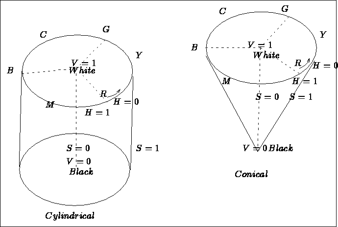

In certain applications, it can be desirable to work in cylindrical coordinates. We change therefore to the "HSV" (Hue, Saturation and Value) coordinate system.
Figure 5.2: Two possible representations of the HSV coordinate system
