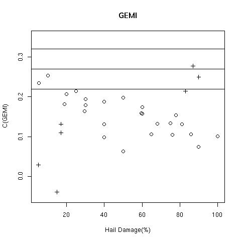

The graph below depicts:
Most damaged parcels have a value Cgemi significantly lower than the three horizontal lines, indicating that the GEMI vegetation index has less increased on damaged parcels than on non damaged ones, thus confirming that hail has altered vegetation growth.
The graph furthermore exhibits a clear negative linear correlation between Cgemi and hail damage assessments, with the exception of seven parcels out of tendancy, marked with crosses. An effect of vine is suspected for these parcels.

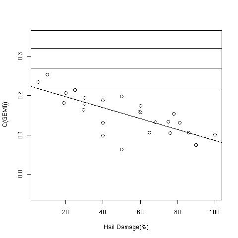

Linear regression has been used to assess hail damage from satellite images. It has been computed on parcels marked with dots (defining set E) and is displayed in the graph below.

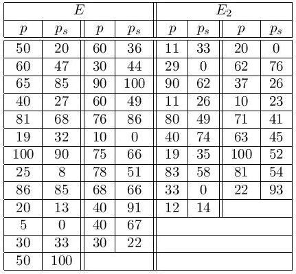

Hail damage assessments ps are computed from Cgemi using the linear regression for each parcel, and compared to the corresponding value p, estimated by experts. The comparison is given in the table below for parcels of sets E (large parcels used for regression) and E2 (small parcels). The overall error (mean value of |p-ps|) is 18%, which is reasonable and allows to conclude on the feasibility of assessing hail damage to vineyards by satellite.
