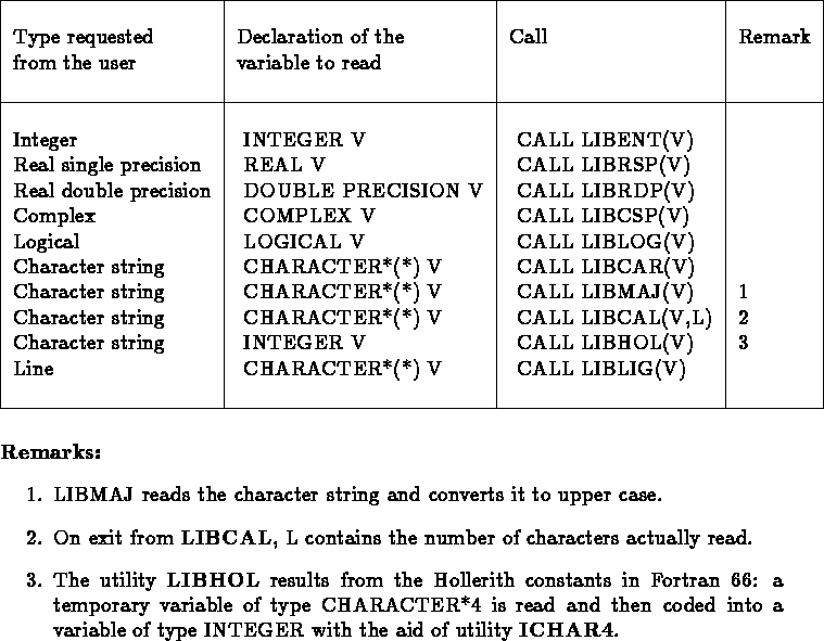

There are several utilities at the programmer's disposal, depending on the type of input data. These utilities are described in figure 1.1.
Figure 1.1: The free format utilities
For example, the instruction:
CALL LIBENT(N)
