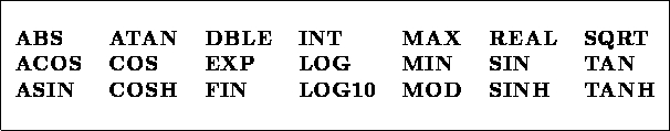

Figure 2.1: The reserved identifiers

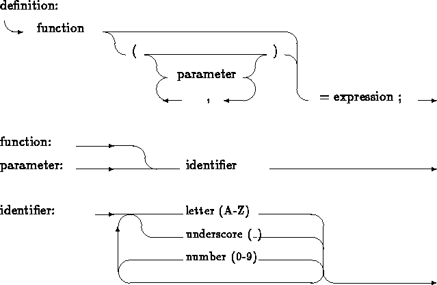

The above syntax is symbolized by the diagram in figure 2.2.
Figure 2.2: Diagram of the function definition
identifier
is a non-empty sequence of letters (A-Z), underscore characters (_) and numbers (0-9). The first character must be a letter or an underscore character. The length of an identifier is only limited by the length of an input line, i.e. 72 characters. The syntax analyzer is responsible for checking that all identifiers differ from reserved words (figure 2.1).
function
is the identifier of the function to be defined, assumed to be single precision real.
parameter1, parameter2, ...
are the identifiers of the formal parameters to be evaluated in the expression, assumed to be single precision real.
expression
is a construction consisting of operands, operators and parentheses, which returns a single precision real value. The operands are parameters or numeric constants. The list of operators available is given in the following section.
a semi-colon
terminates the complete function.

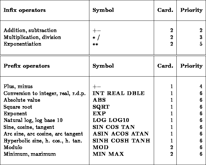

The operators available
Figure 2.3: Priorities of operators
Figure 2.3 gives the cardinality and priority of each prefix and infix operator:
Optimization
In order to optimize on run time and computational precision, certain exponentials are replaced automatically by multiplications. Therefore, do not hesitate to type (X+1)**2 rather than (X+1)*(X+1)!
