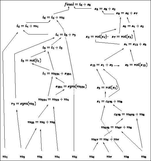

Figure 1.6: Flowchart

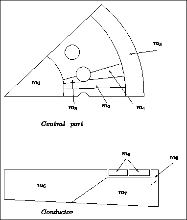

Figure 1.7: Central part and conductor

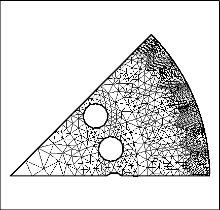

Figure 1.8: Final mesh
