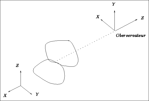

As seen before, it corresponds to first of all positioning the observer with respect to the object. In case of stacking PUSHes and PULLs, it corresponds to positioning an object with respect to another.
Let us take an example: Suppose that we construct the following object composed of two separate objects: PIECE A, a cube with center of gravity 'O' and PIECE B, a cylinder glued onto one of its faces. We can proceed with its description in two different ways:
However, in both cases, we must first position the observer with respect to the object.
Let us adopt the following vocabulary:
A very simple manner to position the observer in the initial space is to use the following subroutine:
      SUBROUTINE NRMLST(XO, YO, ZO, XR, YR, ZR, IVERTI)
      REAL XO, YO, ZO, XR, YR, ZR
      INTEGER IVERTI
where:
(XO, YO, ZO) is the position of the observer in the initial coordinate system;
(XR, YR, ZR) represent the coordinates of the point viewed in the same coordinate system;
IVERTI is the vertical of the initial coordinate system, such that:
We can thus associate a local coordinate system with the observer so that he/she is positioned at its origin, looking in the negative Z direction. This is the normalized position of which we spoke earlier.
Subroutine NRMLST is generally used in conjunction with "PRSPCT".
Figure 4.4:  Coordinates corresponding to the observer

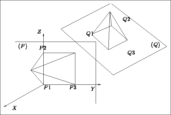

      SUBROUTINE POS3D(P1, P2, P3, Q1, Q2, Q3)
      REAL P1(3), P2(3), P3(3), Q1(3), Q2(3), Q3(3)
where P1, P2 and P3 are the three points in the called object's space , and Q1, Q2 and Q3 are three points in the calling object's space (thus, the above two sets of three points each define a plane in the 3d space).
This transformation enables the user to superpose two planes (and thus position the called object with respect to the calling object) in the following manner:
Figure 4.5:  Transformation contained by calling subroutine POS3D
