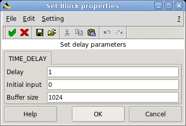

- Delay
The amount of simulation time that the input signal is
delayed before being propagated to the output. The value must be
nonnegative.
Properties : Type 'vec' of size 1
- initial input
The output generated by the block between the
start of the simulation and the Time delay.
- Buffer size
The initial memory allocation for the number of
points to store.
