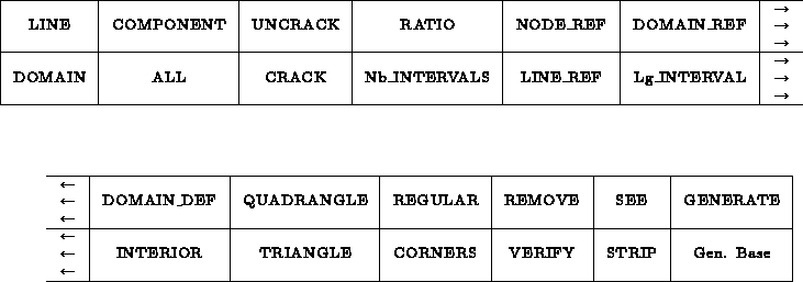

This application is controlled by the application menu on top of the screen (figure 1.26) and the selection menu on bottom of the screen (figure 1.19). It is used to define:
Furthermore, at this point, we have the option of interfacing with the APNOPO mesh generator by generating a data file for the APNOXX preprocessor, see secapnopo.
Figure: The PREP_MESH application menu

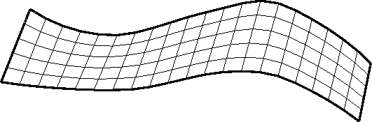

1.5.4. There are two ways of
describing the quadrangular domain, by the four edges or the four vertices:
Figure 1.28: Example of QUANDRANGLE mesh: nb. points: on right and left edges is 6=N, and on lower and  upper edge is 21=M

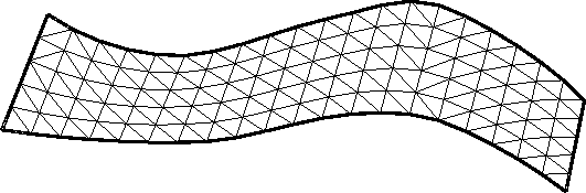

 Requires that the domain be homeomorphic to a square
(deformed quadrangle) with an equal  number of points N  over a couple
of  opposite edges, like in figure 1.29
 ( the case  quadrangle requires the equality
of numbre of points over the two couple of opposites edges , the
`` quadragle mesh'' generator is always used in this case).
(N-2) internal lines are generated, joining correspondind points of
opposite edges and points are distributed on these lines using
interpolation procedures. These (N-2) internal lines definie (N-1)
strips which are divided into triangle using a special option of the
mesh generator (no extra internal points are generated).
Figure 1.29: Example of STRIP mesh, nb. of node: on right and left edges is 6 = N , on lower edge is  11, and  on  upper edge is 31

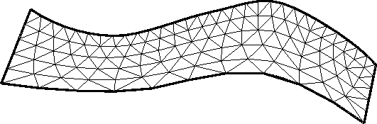

Figure 1.30: Example of Delaunay-Voronoi mesh with the same input than in the previous figure

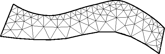

Figure 1.31: Example of STRIP mesh (Quadrangle mesh), nb. of nodes: on right and left edges is 6 = N , and on lower and  upper edge is 21
