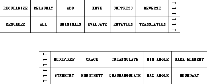

This application is controlled by the application menu (figure 1.32) on top of the screen and the selection menu (figure 1.20) at the bottom of the screen. It is used to edit a 2D mesh constructed from triangles and quadrangles, obtained either by switching from the CONSTRUCTION or PREP_MESH applications to the EDIT_MESH application, or by restoring a mesh (cf. general menus). Briefly, the possibilities are: adding, suppressing, moving the vertices of the mesh, reversing the edge that divides a quadrilateral, quadrangulating, triangulating, regularizing (placing the vertices at the barycenter of their neighbors), making the mesh Delaunay, modifying the references of a mesh (boundaries and subdomains), transforming a subdomain geometrically, renumbering, cracking.
Figure: The EDIT_MESH application menu
