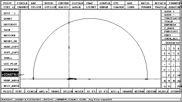

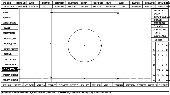

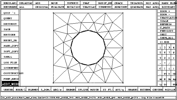

In this section, we show how to mesh a unit square with a hole. First of all, we run emc2, enter the number of the F3D graphic device and answer the few supplementary questions that are posed by the system (this depends on the particular F3D implementation).
 1/4= on the keyboard: a circle of center (.5,.5) and
radius 1/4 is displayed.  Warning: the circle as well as the straight line
is only a construction aid. It must be transformed into an arc
The construction of the geometry is done (figure 1.33).
We can switch to the PREP_MESH application.
Figure 1.33: The geometry of the square domain with a hole

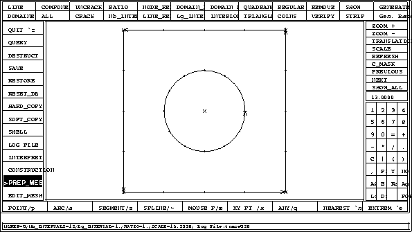

 4= on the keyboard
 12= on the keyboard
Figure 1.34: Discretization of the lines of the square domain with a hole
The file  square_with_hole.emc2_bd :
'-- TYPE N BD(1) BD(2) BD(3) BD(4) BD(5) NBNODE RATIO NUREFG NUREFD NUREF1G NUREF1D NUREF2G NUREF2D FIS' 'DROITE' 1 -1.000000 0.0000000 1.000000 0.0000000 0.0000000 0.0000000 0 0.0000000 0 0 0 0 0 0 F 'DROITE' 2 -1.000000 1.000000 0.0000000 0.0000000 0.0000000 0.0000000 0 0.0000000 0 0 0 0 0 0 F 'POINT' 3 0.0000000 0.0000000 0.0000000 0.0000000 0.0000000 0.0000000 0 1.000000 0 0 0 0 0 0 F 'POINT' 4 0.0000000 1.000000 0.0000000 0.0000000 0.0000000 0.0000000 0 1.000000 0 0 0 0 0 0 F 'POINT' 5 0.0000000 0.0000000 1.000000 0.0000000 0.0000000 0.0000000 0 1.000000 0 0 0 0 0 0 F 'POINT' 6 0.0000000 1.000000 1.000000 0.0000000 0.0000000 0.0000000 0 1.000000 0 0 0 0 0 0 F 'POINT' 7 0.0000000 0.5000000 0.5000000 0.0000000 0.0000000 0.0000000 0 1.000000 0 0 0 0 0 0 F 'SEGMENT' 8 -3.000000 0.0000000 0.0000000 1.000000 0.0000000 0.0000000 5 1.000000 0 0 0 0 0 0 F 'SEGMENT' 9 -3.000000 1.000000 0.0000000 1.000000 1.000000 0.0000000 5 1.000000 0 0 0 0 0 0 F 'SEGMENT' 10 -3.000000 1.000000 1.000000 0.0000000 1.000000 0.0000000 5 1.000000 0 0 0 0 0 0 F 'SEGMENT' 11 -3.000000 0.0000000 1.000000 0.0000000 0.0000000 0.0000000 5 1.000000 0 0 0 0 0 0 F 'CERCLE' 12 0.2500000 0.5000000 0.5000000 0.0000000 0.0000000 0.0000000 2 1.000000 0 0 0 0 0 0 F 'ARC' 13 -2.000000 0.5000000 0.5000000 0.7500000 0.5000000 6.283185 13 1.000000 0 0 0 0 0 0 F 'MASQUE' 0 -0.4632312 1.465731 -5.0000010E-02 1.052500 0.0000000 0.0000000 0 0. 0 0 0 0 0 0 F 'RADIUS' 0 0.2500000 0. 0. 0. 0. 0. 0 0. 0 0 0 0 0 0 F 'ANGLE' 0 0.0000000 0. 0. 0. 0. 0. 0 0. 0 0 0 0 0 0 F 'DISTANCE' 0 1.000000 0. 0. 0. 0. 0. 0 0. 0 0 0 0 0 0 F 'RAISON' 0 1.000000 0. 0. 0. 0. 0. 0 0. 0 0 0 0 0 0 F 'NOMBRE' 0 0.0000000 0. 0. 0. 0. 0. 0 0. 0 0 0 0 0 0 F 'ECHELLE' 0 14.32432 0. 0. 0. 0. 0. 0 0. 0 0 0 0 0 0 F 'NUREF' 0 0.0000000 0. 0. 0. 0. 0. 0 0. 0 0 0 0 0 0 F 'NB_INTERVALS' 0 12.00000 0. 0. 0. 0. 0. 0 0. 0 0 0 0 0 0 F 'NUDSD' 0 1.000000 0. 0. 0. 0. 0. 0 0. 0 0 0 0 0 0 F
We have completed the preparation of the mesh (figure 1.34)
Figure 1.35: The final mesh in the square domain with a hole

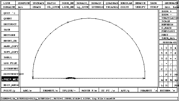

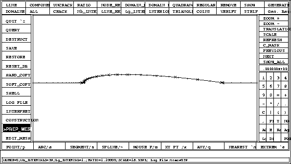

We switch to the PREP_MESH application to define the discretization of the contours.
Figure 1.38: A view of the discretization of all contours
Figure 1.39: Zoom on the discretization of the contours around the naca

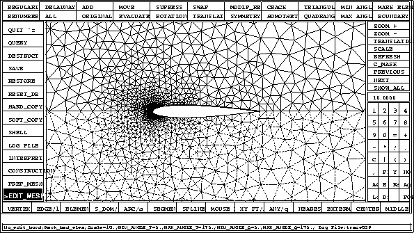

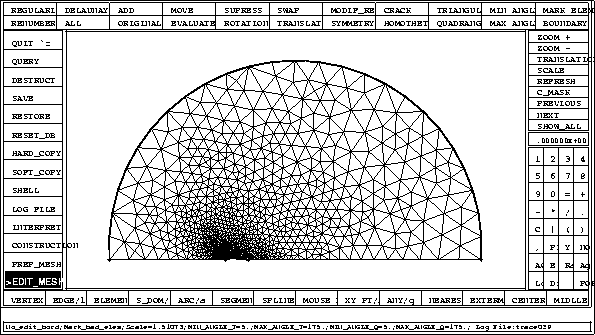

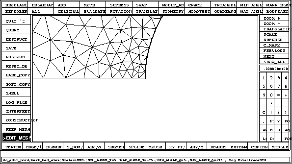

We generate the mesh by switching to the EDIT_MESH application.
Figure 1.40: Mesh around the half naca0012
     We now define references in order to take boundary conditions into
account:
       1 on infinity  , 2 on the NACA, 3 on the trailing edge.

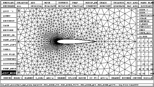

To obtain a complete mesh, we make it symmetrical. First we change point of view to see the whole naca.
Figure 1.42: Zoom 10 on the symmetric mesh of the naca0012
