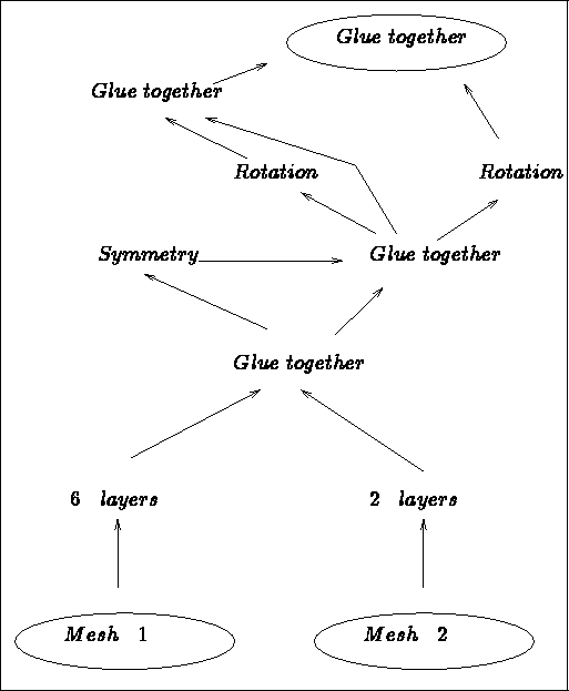

This example corresponds to meshing the domain in figure 2.5. This figure presents symmetries, where only one section was studied. It is, furthermore, topologically cylindrical.
The remainder of this section contains:
up6.bas.psfig:depart2DMesh oneup6.haut.psfig:depart2D1Mesh two
The data file used by APNOXX to create the two 2D meshes which forms the basis, is given below:

The data file used by APN3XX to create the final 3D mesh: we will re-encounter the keywords INTR, MA23, RECO, SYMP, ROTA, SAUV and FIN which specify the operations to be performed to obtain the final mesh:
'EXAMPLE_UP6.2D==>UP.                                                '
