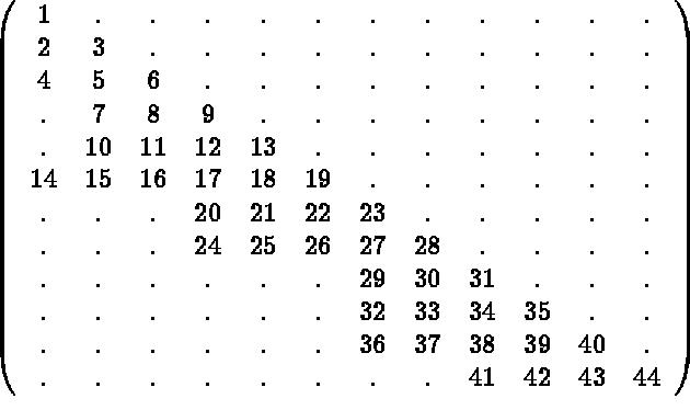

Consider the 12-th order matrix given below (the values correspond to the the rows in the storage and not to the matrix coefficients) constituting 3 pages:
Array MUA5, of length MUA4(13), is subdivided into 3 pages, line 1 to 5, 6 to 10 and 11 to 12. Each page contains a maximum of 32 words. Thus, we have:
Here, each page contains a maximum of 12 words. Thus, we have:
For the symmetric case we store the lower triangular part of matrix A in a one-dimensional array
MUA5 ,
as follows: for each variable i,we store all the coefficients
of the row, for
, (where mc(i) is
the smallest column index such that
). These coefficients (zero or not)
are ordered by increasing column index. The rows are then ordered in order of increasing variable in array MUA5.
To maintain the correspondence between MUA5 and A, a pointer MUA4 is used which gives the address of the diagonal coefficient
in MUA5 for each row i.
The address ia in MUA5 of an arbitrary coefficient
is therefore calculated by the formula
With the convention MUA4(1)=0)
This storage mode, called profile or skyline storage, is particularly useful as it is also used for matrix L. In fact, the matrices A and L have the same profile, and in practice they are often stored in the same array).

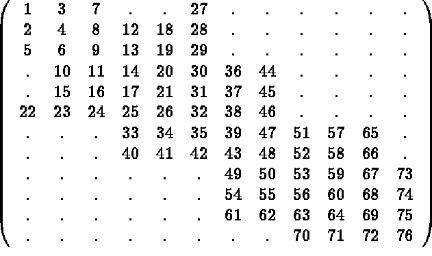

For the non-symmetric case , the same storage is used by adding the columns in the following manner:
for each variable i, we store all the
coefficients
of the row, for
, (where mc(i) is the
are ordered by increasing column index; then we store all the
coefficients
of the column, for
ending with the diagonal coefficient. This information is then ordered
MUA5.
For more details consult [MODULEF User Guide - 2].
