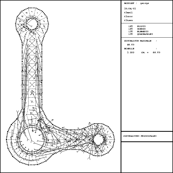

Figure 3.7: Example TRSTXX 2D: mesh and principal stresses

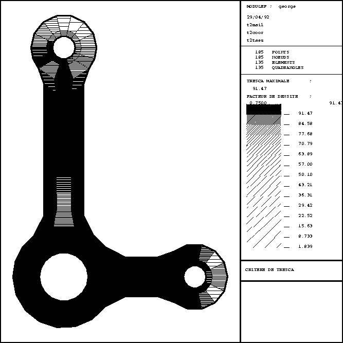

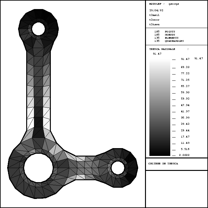

Figure 3.8: Example TRSTXX 2D: mesh and stresses (Tresca's criterion)
Figure 3.9: Example TRSTXX 2D: stresses (Tresca's criterion) with shading
