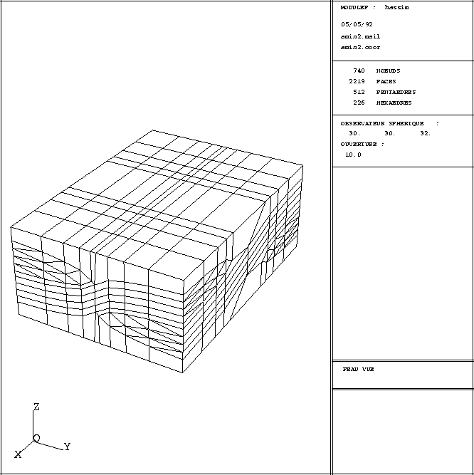

Request first a plot of the mesh (see above). The menu is as indicated above. The plot example given corresponds to the following sequence:
Figure 3.10: Example TRC3XX 3D: mesh, seen faces

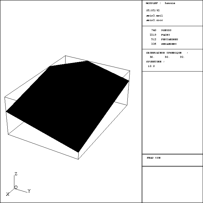

Departing from the plot displayed we then define a cut via the graphics menu to obtain a plot shown in figure 3.11, in which the cut plane is displayed, by inputting the following data:
Figure 3.11: Example TRC3XX 3D: cut through the above mesh

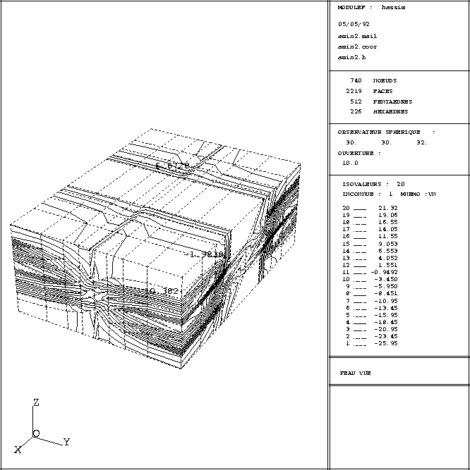

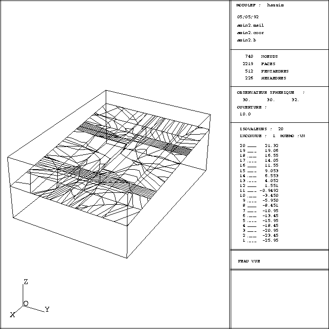

The only new feature is the item to obtain the value of an isovalue. There are several ways of performing this interrogation. One way corresponds to typing the letter and clicking on the isovalue under consideration, as for the two-dimensional case (see TRMCXX).
The plots were obtained by typing the following sequences:
Figure 3.12: Example TRC3XX 3D: Mesh and isovalues
Figure 3.13: Example TRC3XX 3D: Isovalues on a cut
