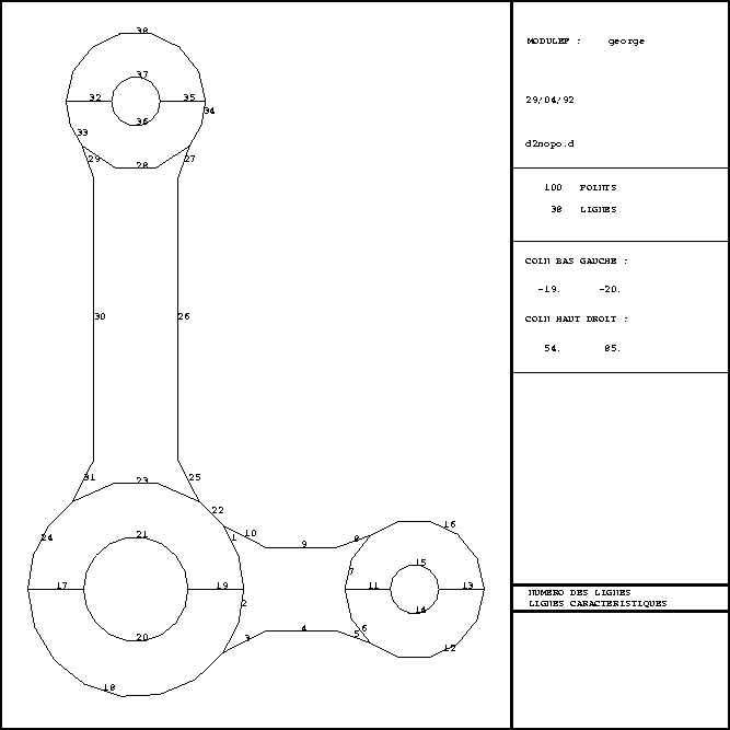

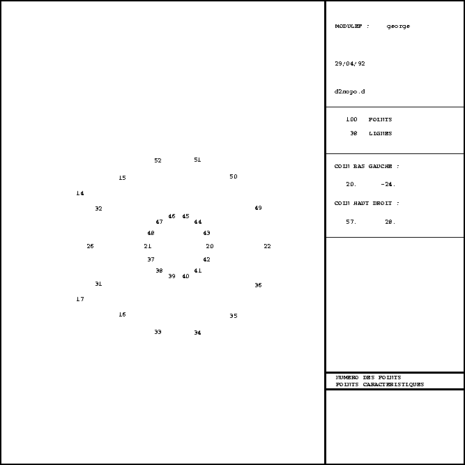

Figure 6.2: Example TRPOXX: zoom in on the characteristic points
Figure 6.3: Example TRPOXX: numbers of the characteristic lines
