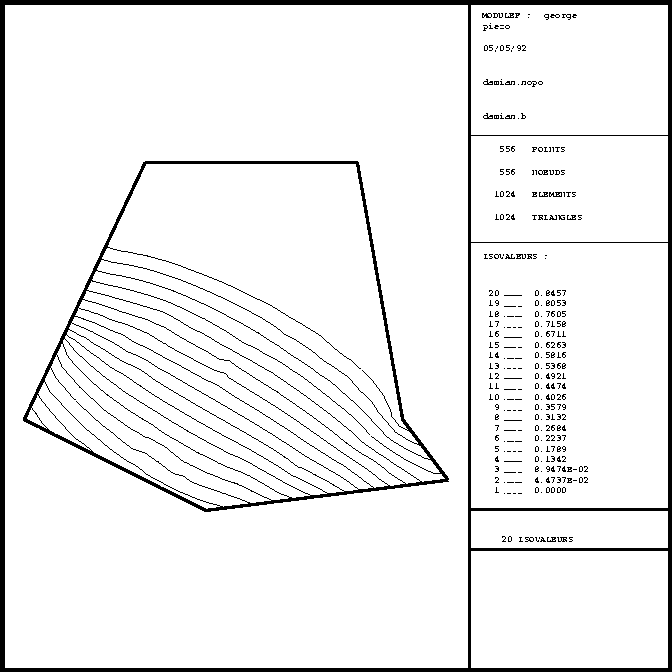

In the case of a 2D problem modeled using Lagrange elements of degree 1 for which the mesh is known in the form of a NOPO structure and the solution is a B structure, preprocessor ISOPXX is used to plot the isovalues (it corresponds to a poor version of TRMCXX). In reality, this preprocessor was written to visualize solutions (piezometric pressure and head) of an incompressible fluid flow problem in a porous medium.
In practice, using preprocessor ISOPXX, the user indicates to the module the different choices made from the possibilities offered.
The module computes the extrema corresponding to the mesh and solution automatically so that the corners of the box in which the plot will be displayed can be defined.
The menu of ISOPIE (module called in this case) is identical to that obtained for TRNOPO (module used to plot a 2D mesh, to which the user is referred) By activating key 10, we indicate that the solution must be considered after which the name of the file containing it must be entered. The enlarged menu is shown below;
------------------------------------------------------------ | 10 | PLOT TYPE | MESH AND ISOVALUES ------------------------------------------------------------ | 11 | DEVICE NUMBER | 1 ------------------------------------------------------------ | 12 | PLOT TITLE | piezo ------------------------------------------------------------ | 20 | D.S. NOPO TO PLOT | damian.nopo ------------------------------------------------------------ | 21 | S.D. B IN USE | damian.b ------------------------------------------------------------ | 24 | LOAD CASE | 1 ------------------------------------------------------------ | 27 | ARRAY B4 SELECTED | 1 ------------------------------------------------------------ | 28 | CLASSICAL PROBLEM | ------------------------------------------------------------ | 32 | D.O.F. CHOSEN | 1 ------------------------------------------------------------ | 25 | NUMBER OF ISOVALUES | 20 ------------------------------------------------------------ | 26 | ISOVALUE CHOICE | MIN < ** < MAX ------------------------------------------------------------ | 72 | ISOVALUES PLOT | COLOUR LINE ------------------------------------------------------------ | 45 | COLOR SPECTRUM | STANDARD : RED -> BLUE ------------------------------------------------------------ | 46 | SPECTRUM DIRECTION | DIRECT ------------------------------------------------------------ | 34 | COLOR-VALUE IMPOSED | NO ------------------------------------------------------------ | 71 | ISOVALUES ARE POINTED | NO ------------------------------------------------------------ | 31 | QUESTIONS ABOUT A D.S. | NO ------------------------------------------------------------ | 30 | PLOT SIZE | AUTO ------------------------------------------------------------ | 40 | CHARACTER TYPE | HARD ------------------------------------------------------------ | 50 | ITEMS TO PLOT | TRIANGULATION ------------------------------------------------------------ | 60 | LEGEND | YES ------------------------------------------------------------ | 70 | NUMBER | NONE ------------------------------------------------------------ | 80 | LINE TYPE (MESH) | SOLID ------------------------------------------------------------ | 80 | LINE TYPE (ISOVALUES) | SOLID ------------------------------------------------------------
A default value is proposed for each option. The above table lists the selections made automatically. Type 0 to obtain a plot.

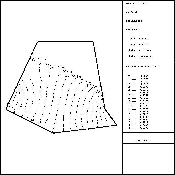

MESH : 0 -- ISOVALUES : 1
PRESSURE : 1
PIEZOMETRIC HEAD : 2

The plots were obtained by typing the following sequences:
Figure 6.4: Example ISOPXX: pressure
Figure 6.5: Example ISOPXX: piezometric head
