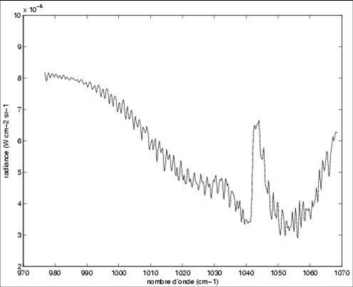

- Examples of simulated IASI data: raw radiance spectrum (left), 0-6km
(right): mean error compared to reference: 27%, instead of expected 20%
accuracy of the 0-6km column.

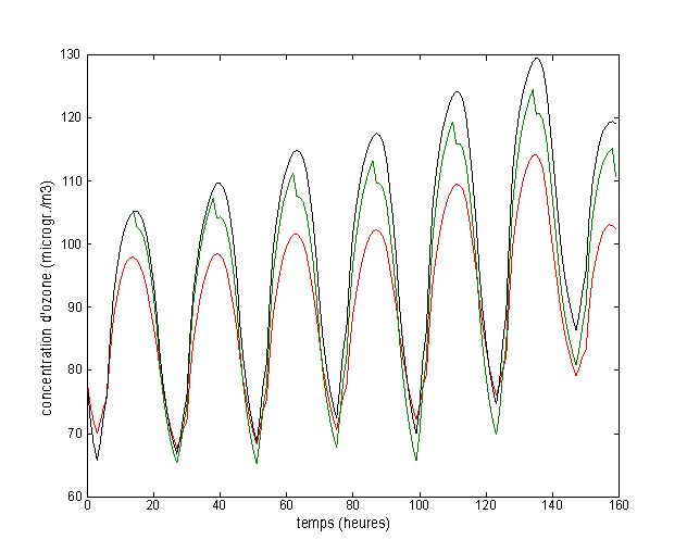

Simulated data have been assimilated using Polyphemus Optimal Interpolation
driver. The data have been assimilated into a perturbated model and compared
to the reference. The error of the forecast is 13% without assimilation,
9% with assimilation. Below an example of assimilation: mean ozone profile
at ground level: red curve represents the reference, black curve the
perturbated model (increase of NOx emission by 30%, of O3 boundary conditions
by
15%, decrease of O3 deposition by 15%), green curve the analysis.
