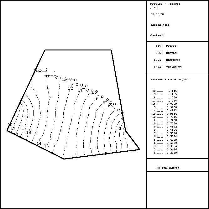

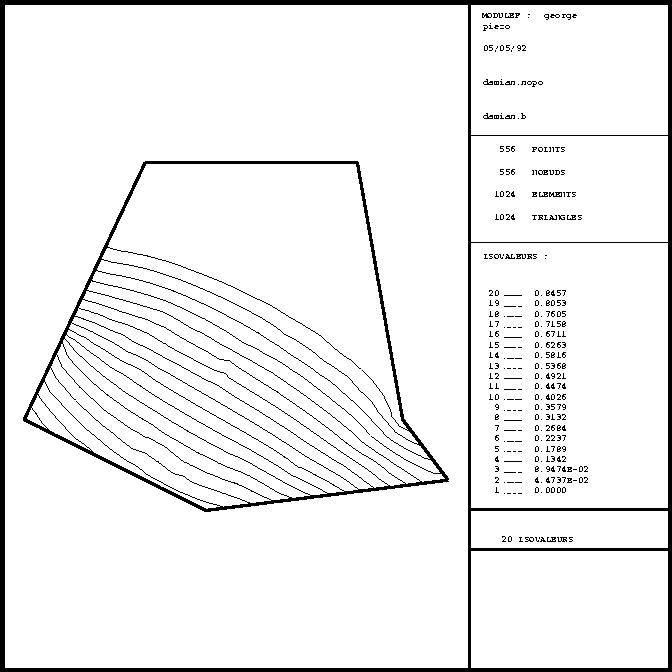

------------------------------------------------------------ | 10 | TYPE DU DESSIN | MAILLAGE ET ISOVALEURS ------------------------------------------------------------ | 11 | NUMERO DU PERIPHERIQUE | 1 ------------------------------------------------------------ | 12 | TITRE DU DESSIN | piezo ------------------------------------------------------------ | 20 | S.D. NOPO A DESSINER | damian.nopo ------------------------------------------------------------ | 21 | S.D. B UTILISEE | damian.b ------------------------------------------------------------ | 24 | CAS DE CHARGE | 1 ------------------------------------------------------------ | 27 | TABLEAU B4 SELECTIONNE | 1 ------------------------------------------------------------ | 28 | PROBLEME CLASSIQUE | ------------------------------------------------------------ | 32 | DEGRE DE LIBERTE CHOISI | 1 ------------------------------------------------------------ | 25 | NOMBRE D'ISOVALEURS | 20 ------------------------------------------------------------ | 26 | CHOIX DES ISOVALEURS | MIN < ** < MAX ------------------------------------------------------------ | 72 | DESSIN DES ISOVALEURS | AU TRAIT COULEUR ------------------------------------------------------------ | 45 | SPECTRE DE COULEURS | STANDARD : ROUGE -> BLEU ------------------------------------------------------------ | 46 | SENS DU SPECTRE | DIRECTE ------------------------------------------------------------ | 34 | COULEUR-VALEUR IMPOSE | NON ------------------------------------------------------------ | 71 | MARQUAGE DES ISOVALEURS | NON ------------------------------------------------------------ | 31 | QUESTIONS SUR UNE S.D. | NON ------------------------------------------------------------ | 30 | TAILLE DU DESSIN | AUTO ------------------------------------------------------------ | 40 | TYPE DES CARACTERES | HARD ------------------------------------------------------------ | 50 | ITEMS TRACES | TRIANGULATION ------------------------------------------------------------ | 60 | LEGENDE | OUI ------------------------------------------------------------ | 70 | NUMERO | AUCUN ------------------------------------------------------------ | 80 | TYPE DES TRAITS (MAILLAGE)| CONTINU ------------------------------------------------------------ | 80 | TYPE DES TRAITS (ISOVAL.) | CONTINU ------------------------------------------------------------
Pour chaque option, une valeur par défaut est proposée. Le tableau ci-dessus liste les choix automatiques retenus. Pour obtenir un tracé, on tape 0.
A chaque item correspondent une clé (un numéro) et un état. Pour modifier l'état, il suffit de taper la clé et de donner éventuellement (cf. introduction générale) les valeurs correspondant à l'état souhaité. Le menu général initial est identique à celui obtenu en utilisant TRNOXX en 2D. Choisissant, via la clé 10, de dessiner une solution, on obtient la liste de clés suivante:
    MAILLAGE   : 0  --  ISOVALEURS : 1
    PRESSION              : 1
    HAUTEUR PIEZOMETRIQUE : 2
  -- MAILLAGE
     RIEN                    : 0
     TRIANGULATION           : 1
     CONTOUR GEOMETRIQUE     : 2
    CONTINU  : 1  --   POINTILLE : 2
    TIRETE   : 3  --   MIXTE     : 4 ?
et le même choix pour le tracé des isovaleurs.
Un dessin étant affiché à l'écran, on dispose, comme pour les autres modules, d'un menu graphique.
Exemples
Il s'agit d'un exemple pris dans [RM 110]. Les dessins ont été obtenus en tapant les séquences suivantes:
Figure 6.4:  Exemple ISOPXX: pression
Figure:  Exemple ISOPXX: hauteur piézométrique
