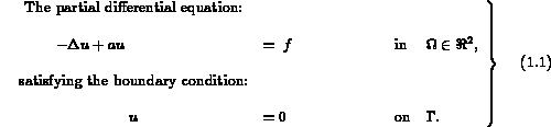

Consider the following Dirichlet boundary value problem:
f
, and
a
, i.e.,
a
, where is a regular open subset of with a regular boundary .

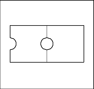

    In the figure 1.1, the body is clamped at boundary AF, and pulled along boundary CD. It is composed of two materials, with a circular hole and a half-circle.
    In this configuration there are two sub-domains:
    1. the copper domain ABEF, and
    2. the iron domain BCDE,
    and at least four reference numbers:
    1. to define the circles which form the boundary of the hole and half-circle, and the line which partitions the domain into two sub-domains,
    2. to define the fixed portion of the boundary, and
    3. to define the edge DC where the load is applied.
    Remark: Lines AC and FD do not have reference numbers assigned as no particular conditions applies there.
    Figure 1.1: Clamped body with applied load

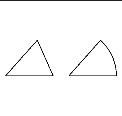

    Consider the two elements illustrated in figure 1.2: a straight P2 triangle and a curved P2 triangle. A straight element is an element whose points are the vertices. A curved element is an element whose points are the vertices plus some other characteristics. In the case of a P2 triangle, the straight element is defined by 3, and the curved element by 6 points, both having 6 nodes.
    Figure 1.2: P2 triangular elements
