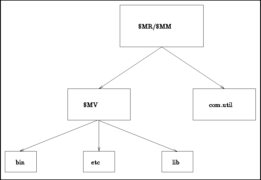

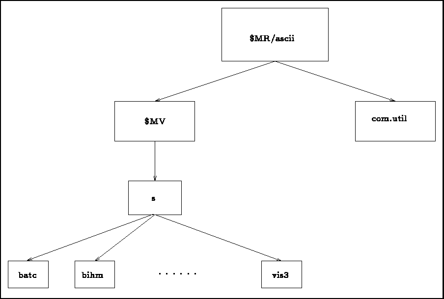

Figures 2.1 and 2.2 illustrate the organization of the directories containing the
MODULEF source code ( $MR/ascii) and the non-portable part of MODULEF ( $MR/$MM), respectively.
In figure 2.1 batc, bihm and vis3 are the libraries containing the
MODULEF source
code. Directory com.util contains shell files
for the management of the MODULEF library.
Figure 2.1: Organization of the MODULEF source code
The contents of the directories, shown in figure 2.2, are as follows:
- $MR/$MM/$MV/bin: the executable programs,
- $MR/$MM/$MV/etc: files liblist, sourcelist
and maj.fo (the latter contains the list of modifications performed on the MODULEF source files), and
- $MR/$MM/$MV/lib: the object libraries
( libbatc.a,
libbihm.a, ..., libvis3.a),
- $MR/$MM/com.util: the executable programs corresponding to the C programs contained in directory
$MR/ascii/com.util/s.
Figure 2.2: Organization of the non-portable part of MODULEF
