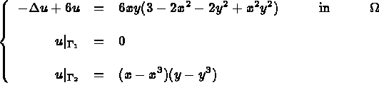

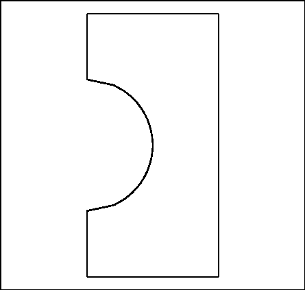

Consider the following boundary value problem:
Figure 2.1: An introductory example
The exact solution to the above problem is given by:

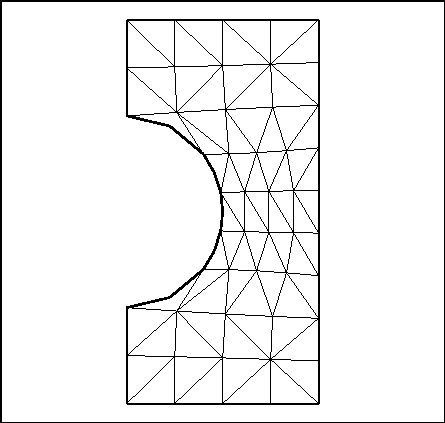

The resulting mesh is shown in figure 2.2.
Figure 2.2: The mesh (plot generated by TRNOXX)

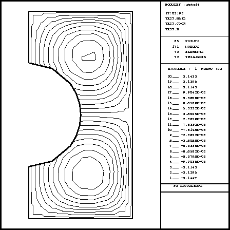

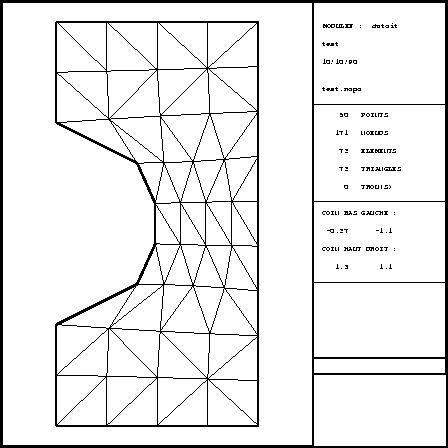

The results are plotted with the aid of preprocessor TRMCXX. The plot shown in figure 2.3 is generated by calling preprocessor TRMCXX and specifying the file names in which the I.D.S. MAIL and I.D.S. COOR are stored. The isovalues are plotted by the same preprocessor, by selecting the appropriate option from the plot menu and entering the name of the file containing I.D.S. B. The resulting plot is shown in figure 2.4.
Comments: Note the difference between the mesh plot obtained with TRNOXX and the one obtained by TRMCXX. In the former the interpolation was not known.
Figure 2.3: Mesh (plot generated by TRMCXX)
Figure 2.4: The isovalues (plot generated by TRMCXX)
