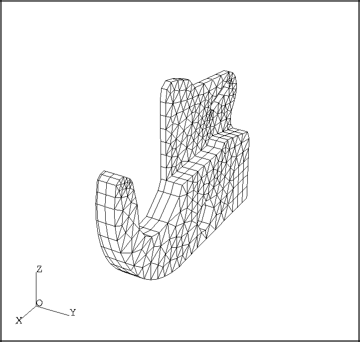

The example chosen is the solution of a realistic linear elasticity problem by the finite element method: a hook, greased on part of its boundary, is submitted to a vertical traction force on the utility part. Given the envisaged boundary conditions, and the material assumed homogeneous isotropic, the problem exhibits a symmetry plane, so that the domain is reduced to a half-hook (see Figure 1).

Figure 1.1: Mesh of the domain
The geometry of the model problem is described by a NOPO data structure, and a view of the object is presented in Figure 1.1. The mesh contains 1006 elements and 937 nodes, the finite elements used being of degree 1.

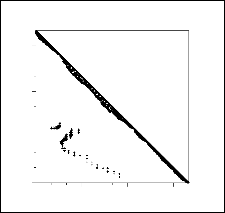

At each of the nodes, we need to compute the three displacement components, so that the resulting linear system has 2811 unknowns. The structure of the matrix of the linear system is represented in figure 1.2.
