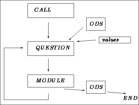

In general, the organization of the plotting modules of the MODULEF library can
be schematized as follows:
Figure 1.1: General organization of the plotting modules
- From a practical point of view, a visualization is performed by executing preprocessor
"CALL" (see figure 1.1) which calls program "QUESTION".
- This program then requests the user to choose the output device and to indicate the file name(s) containing the
data structure(s) ("IDS" in the flowchart) required, or the numerical values ("values" in the flowchart)
to plot.
- A general menu or status table is then displayed (in alphanumeric mode), which indicates the
visualization parameters, i.e., for each item described, the manner in which it is treated, or the visualization
choices available.
- An immediate visualization (the "MODULE" is activated) can also be requested, which corresponds to
automatic mode visualization.
- Furthermore, the user can also modify values in the status table until the desired visualization
parameters are set before requesting the corresponding visualization.
- Once the plot is displayed, a graphics menu appears on the screen to enable the user to perform
certain graphical operations.

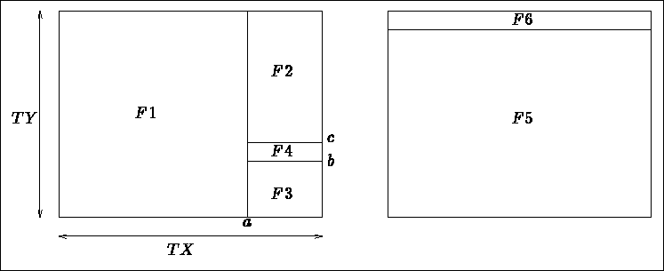

Figure 1.2: Presentation of the screen with and without the general legend
The plot occupies a box of size on the screen (figure 1.2). This box is split
into different zones or windows in which are displayed:
- If a general legend is requested (default option):
- the object in F1,
- the general legend in F2.
- the graphics menu in F3,
- a quick indication of the type of plot in F4.
- If we request no general legend (key 60 in the general menu, see below):
- the object in F5,
- the graphics menu in F6.
The size of the windows is determined as a percentage of the size of the box chosen, which is a function
of the device used. The box dimensions are calculated automatically (the entire screen is subdivided),
or input by the user (in centimeters).
